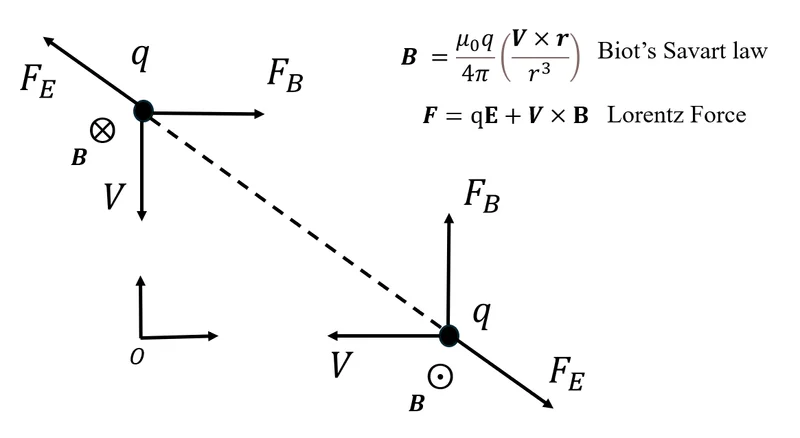

There are textbook examples in electromagnetism in which you may notice that the third law of Newton may not hold in its conventional form. That does not necessarily mean that momentum balance is violated, as briefly mentioned in [1]. One example you can easily check is the magnetic force between two perpendicularly moving charges as they approach a reference point. If you use the Biot-Savart law, you will notice that the forces are not canceling and are not aligned with the interaction line (See the picture below). There is no miscalculation here. Please see Feynmann's lecture notes[1], chapter 27, or see Griffith's textbook [2] section 8.2.1.
Another example similar to the one above is two perpendicular wires carrying currents i1 and i2; you can see that the magnetic forces are not in the same direction and do not cancel. This is similar to the example above because currents are the movement of many single charge carriers at a drift velocity.

We can see that magnetic forces can be non-central, meaning that interactions do not strictly act along the straight line connecting the centers of two objects.
At this point, one can propose " We can have a propulsion system by just having two wires with an engineered configuration. " However, mathematically it can be shown, in closed circuits, no matter what shape or configuration we choose, the magnetic force always cancels, and action and reaction are symmetric and cancel each other(See Equations 5.8- 5.10 of Jackson[3]).

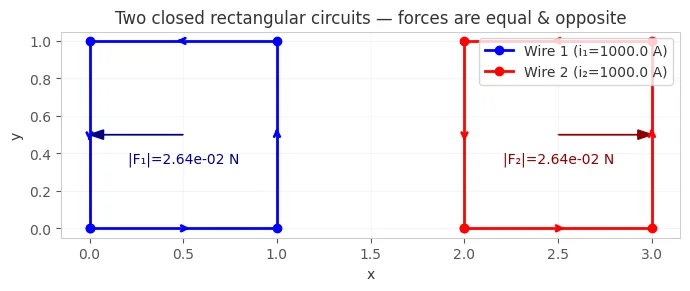

Until now, everything has been fine. Now, I want to run a hypothetical experiment. I take two closed circuits and put a sufficiently small gap in one of them so that it is no longer a closed circuit. The gap acts as a capacitor, helping maintain the electric field needed to keep the current flowing. I calculate the magnetic forces of these two cases:
Case 1: Two closed circuits
As we should expect, two closed circuits should apply equal and opposite forces on each other. Please find the online Python code compiler and the code for it here (It will take time the first time you run because of installing dependent libraries for plotting)

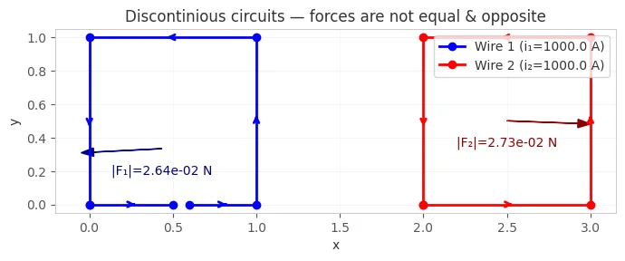

Case 2: Discontinuous circuits
Now, I slightly change the geometry of the wires by introducing a gap, modifying the code, and computing the magnetic force using the Lorentz force and Biot-Savart law (Please find the code and online compiler here)
We see that introducing a discontinuity prevents the magnetic forces from canceling each other. Is it because magnetic forces are non-central? These forces are computed numerically, and you may doubt their correctness, but an analytical general proof is possible, as we did above. (Let me know if you are interested)
Now my question comes. By this example, can we state that a system can change its center of mass without external force or external stimulation? I don't mean necessarily permanently, even periodically, so the center of mass vibrates? Even if a system can have its own net force for an instance of time, can we conclude self-force is possible? Can we conclude that a change in the center of mass is possible with some other mechanism other than a photon thruster by purely using the near-field part of the electromagnetic field?
What do I or we need to reconsider here?
Thanks for any explanation you may provide.
The Biot Savart law doesn’t apply to the modified circuit. The Biot Savart law is only valid for magnetostatic situations. You would need to use Jefimenko's equations instead.

You are neglecting the E field and the ##\rho## and ##\dot \rho## terms of Jefimenko's equations. Including those two terms was the whole point of using Jefimenko's equation. The retardation is important, but not the primary reason you needed to use Jefimenko's equations.
aslan666 said:
We have strong near-field forces that do not cancel out
It cannot happen. Conservation of momentum follows from Maxwell’s equations. If you ever do any EM calculation that says otherwise then you know for certain that you have violated Maxwell’s equations somewhere. In this case specifically you violated Maxwell's equations by neglecting ##\vec E##, ##\rho## and ##\dot \rho##, but you can always know from first principles that if you get a violation of the conservation of momentum then you made a mistake.
Momentum can go from the circuit to the fields. If it stays near then it is still part of the system, just like throwing a ball inside a car. The only way for the momentum to leave is to throw it away from the system, just like throwing a ball out of a car. That is the difference between near fields and far fields.
aslan666 said:
If far fields can produce net thrust, why can't we think near fields can do too?
Because momentum is conserved. Near fields cannot do it for the same reason throwing a ball inside a car cannot do it.
