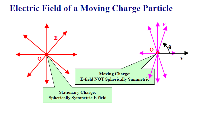

The electric field will be given by columb's law if and only if the charge is stationary in your frame of reference. If the charge is moving in your frame, the electric field will get squashed by the Lorentz contraction, looking something like this:
see
http://www.phys.ufl.edu/~rfield/PHY2061/images/relativity_15.pdf for the full figure, the image above is a copy of part of the original, copied under the "fair use" provision and intended to inspire you to look at the original author's webpage.
Note that there is in no sense any special frame of reference- when you move with the same velocity as the charge, i.e. you and the charge are co-moving, the field is symmetrical. When you move at some different velocity, the field of the charge is no longer symmetrical, it gets "squished" as above.
And the numerical transformation laws are given a few slides earlier:
http://www.phys.ufl.edu/~rfield/PHY2061/images/relativity_13.pdf
the parallel component of the e-field, doesn't change, but the transverse component of the E-field gets multiplied by the relativistic factor gamma.
