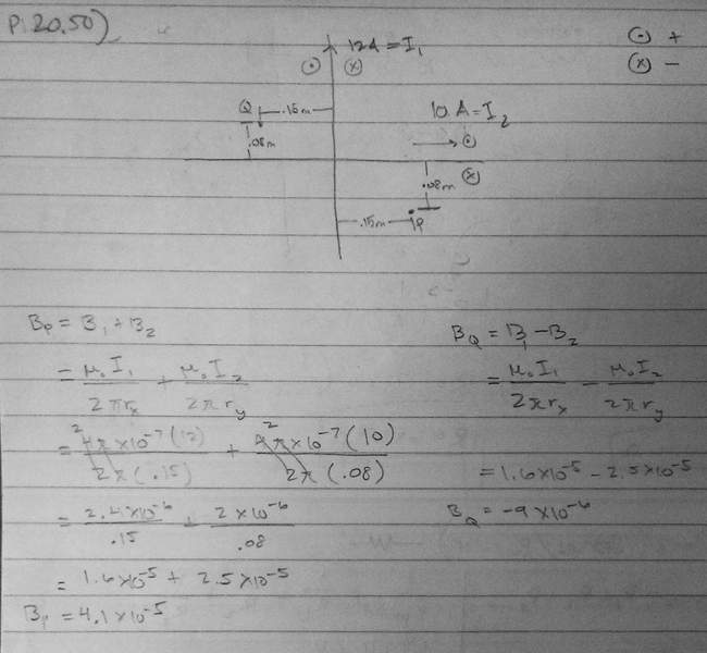

A) Find the magnitude of the net magnetic field at point P and point Q
B) Reverse the directon of the current for the wire on the x-axis
B = μ0I/2πr
Solution attempt attached. Only attempted part A, since I probably won't get part B correct if I'm not getting part A. Tried a few other permutations, but still arrived at similarly incorrect solutions. I'm a bit lost still. I thought adding the magnitudes of the B-fields at the points would give me the solution. Either that or my calculations are wrong, my algebra skills are out of practice.

Are both wires infinitely long? (It makes a difference)
If so, it looks like you are on the right track, but you need to be more careful with your sign conventions and the right-hand rule.
According to your work, out of the paper is defined as positive and into the paper is defined as negative. That's as good a convention as any. But once you have a convention, you need to stick to it.
Now you can break up the magnetic field at each point P and Q into their respective contributions of each wire. Let's start with point P.
BP = BP1 + BP2.
And assuming that the wires are infinite in length and point P is on the same plane as the wires, all magnetic field components have directions perpendicular to the page, so we can give up our vector notation and deal with scalars:
BP = BP1 + BP2
You already [essentially] have that on your attempted solution. But what you may have missed is that it doesn't mean that BP1 and BP2 are necessarily positive. One or both might be negative.
Use the right hand rule separately on BP1 and BP2 to figure out if each one is positive or negative.
Moving to point Q, you have on your attempted solution,
BQ = BQ1 - BQ2
But that's not right. You should have
BQ = BQ1 + BQ2
and then realizing that BQ1 and/or BQ2 can be positive or negative. In any case, whether they are both positive, one is negative, or both are negative, everything still gets added together.
(For example, if BQ1 points out of the page it's positive. Otherwise if it points into the page it's negative. You can do this with one wire, and one point at a time.)
