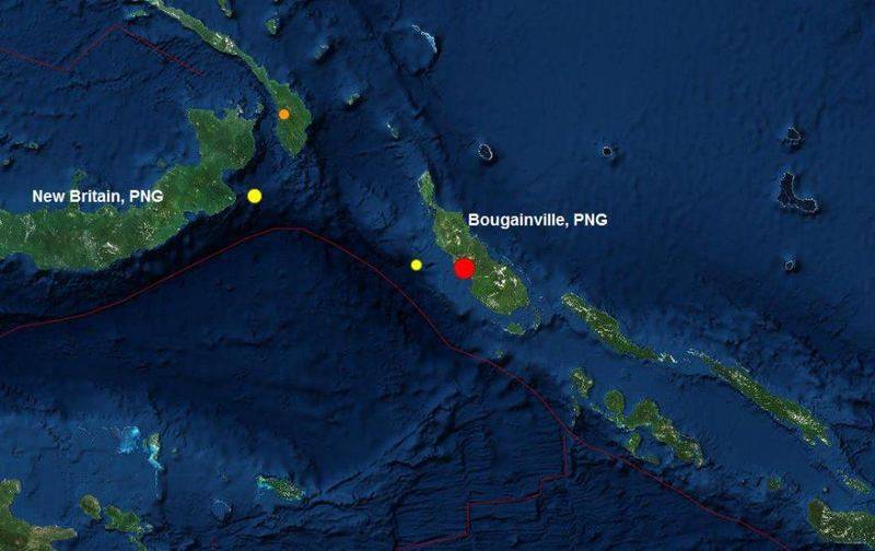

Location map
M 8.0 40km W of Panguna, Papua New Guinea
2017-01-22 04:30:24 (UTC)
153.8 km deep

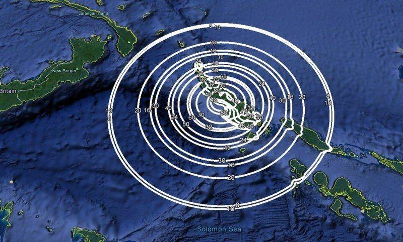

I'm wondering what the peak ground acceleration was. I wonder if they have any accelerometers in place at any of the mines.
looks like it got up around 80% of g

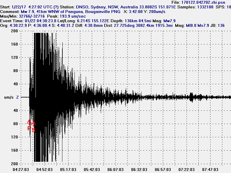

raw seismogram screenshot off my system, just before it started to overwrite the previous line
Processed file

Oops, I mean wow! Is the tsunami warning still active? Or has there been one. ##0.8 \,g## sounded a lot.
there was an alert put out, but was canceled after it was found that there were no significant waves generated
fresh_42 said:
0.8 g sounded a lot.
pretty significant, but by no means the largest
exceeding 1g happens periodically with larger events, M6 and up ... lots of factors come into play, type of fault motion, ground type
to name a couple.
The M 6.3 quake that wrecked Christchurch, NZ in Feb. 2011 had a peak ground accel. of 220.3% g pretty much above the focus.
there was a soft ground location some 10 km to the north ( just east of the city centre) that hit 188.7% g
pretty serious recordings for a moderate event
Dave
