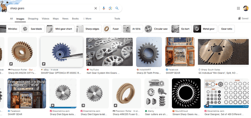

Kiblur said:
I am however worried that the shag of the carpet will cause the vehicle to deviate. Am I right to worry about this?
You might think about using wheels that dig into the carpet a bit to avoid getting deviated very much. Something like sharp gear-shaped wheels or similar...
From a Google Images search on sharp gears:
