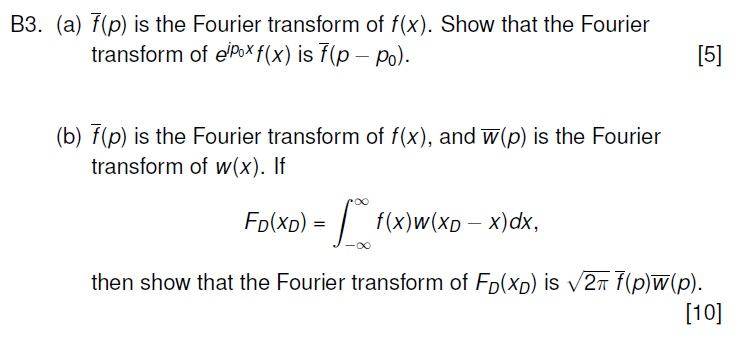

Typeset homework problem B3 with two parts: (a) show that the Fourier transform of e^(ip0x) f(x) is f̃(p − p0); (b) show that the Fourier transform of F_D(x_D) = integral from −∞ to ∞ of f(x) w(x_D − x) dx is √(2π) f̃(p) w̄(p). Marks [5] and [10] are shown.
I think I'm ok with the first part. I start with:
##\widetilde{f}(p) = \frac{1}{\sqrt{2\pi}} \int_{-\infty}^{\infty} \! e^{-ipx}f(x) \, \mathrm{d}x##
Then moving on to the transform for ##e^{ip_0 x}f(x)## I get:
##\frac{1}{\sqrt{2\pi}} \int_{-\infty}^{\infty} \! e^{-ipx}e^{ip_0 x}f(x) \, \mathrm{d}x##
## = \frac{1}{\sqrt{2\pi}} \int_{-\infty}^{\infty} \! e^{-i(p-p_0)x}f(x) \, \mathrm{d}x##
## =\widetilde{f}(p-p_0)##
However I'm really not sure what to do for part b).
Here's my attempt so far:
Starting with:
##F_D(x_D) = \int_{-\infty}^{\infty} \! f(x)\Big[w(x_D - x)\Big] \, \mathrm{d}x##
The ##w(x_D - x)## part is similar to the previous section so I plug that into get:
##F_D(x_D) = \int_{-\infty}^{\infty} \! f(x) \, \Big[\frac{1}{\sqrt{2\pi}} \int_{-\infty}^{\infty} \! e^{-i(x_D -x)p}\widetilde{w}(p) \, \mathrm{d}p\Big] \mathrm{d}x##
then rearrange a little to get:
##F_D(x_D) = \Big(\frac{1}{\sqrt{2\pi}}\int_{-\infty}^{\infty} \! e^{ixp}f(x) \, \mathrm{d}x\Big) \int_{-\infty}^{\infty} \! e^{-ix_D p}\widetilde{w}(p) \, \mathrm{d}p##
The part in brackets is the transform giving ##\widetilde{f}(p)## so,
##F_D(x_D) = \widetilde{f}(p) \int_{-\infty}^{\infty} \! e^{-ix_D p}\widetilde{w}(p) \, \mathrm{d}p##
which can be neatened a little into:
##F_D(x_D) = \widetilde{f}(p)\widetilde{w}(p) \int_{-\infty}^{\infty} \! e^{-ix_D p} \, \mathrm{d}p##
so now I have ##F_D(x_D)## written in a way that's already starting to look like the desired outcome. However it only gets messy now as I do the Fourier transform:
##\frac{1}{\sqrt{2\pi}} \int_{-\infty}^{\infty} \! e^{ix_D p}\Big[F_D(x_D)\Big] \, \mathrm{d}x_D = \frac{1}{\sqrt{2\pi}} \int_{-\infty}^{\infty} \! e^{ix_D p}\Big[\widetilde{f}(p)\widetilde{w}(p) \int_{-\infty}^{\infty} \! e^{-ix_D p} \, \mathrm{d}p\,\Big] \mathrm{d}x_D##
The exponents cancel to leave
##\frac{1}{\sqrt{2\pi}} \widetilde{f}(p)\widetilde{w}(p) \int_{-\infty}^{\infty} \! \int_{-\infty}^{\infty} \! \, \mathrm{d}p\, \mathrm{d}x_D##
which I really don't think is a very good result!
Any input would be much appreciated. Thanks.

Can you explain why it is allowed to move ##\tilde w(p)## in front of the integral sign ?

Ah, I see now, it can't be shifted over because it's a function of p so it needs to stay within the integral over dp.
Furthermore I've just been looking through some old lecture notes and it turns out I was very much on the right track (woohoo!). The question is essentially proving the convolution theorem.
So I'd got to the point:
##F_D(x_D) = \widetilde{f}(p)\int_{-\infty}^{\infty} \! e^{-ix_D p}\widetilde{w}(p) \, \mathrm{d}p##
which actually neatens up to
##F_D(x_D) = \int_{-\infty}^{\infty} \! e^{-ix_D p}\widetilde{f}(p)\widetilde{w}(p) \, \mathrm{d}p##
which can be made into a standard Fourier transform by adding factors of ##\sqrt{2\pi}##:
##\frac{1}{\sqrt{2\pi}}F_D(x_D) = \frac{1}{\sqrt{2\pi}}\int_{-\infty}^{\infty} \! e^{-ix_D p}\widetilde{f}(p)\widetilde{w}(p) \, \mathrm{d}p##
then taking the inverse:
##\frac{1}{\sqrt{2\pi}}\widetilde{F}_D(p) = \widetilde{f}(p)\widetilde{w}(p)##
which clearly leads to the desired result:
##\widetilde{F}_D(p) = \sqrt{2\pi}\widetilde{f}(p)\widetilde{w}(p)##
