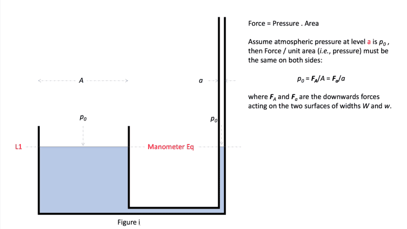

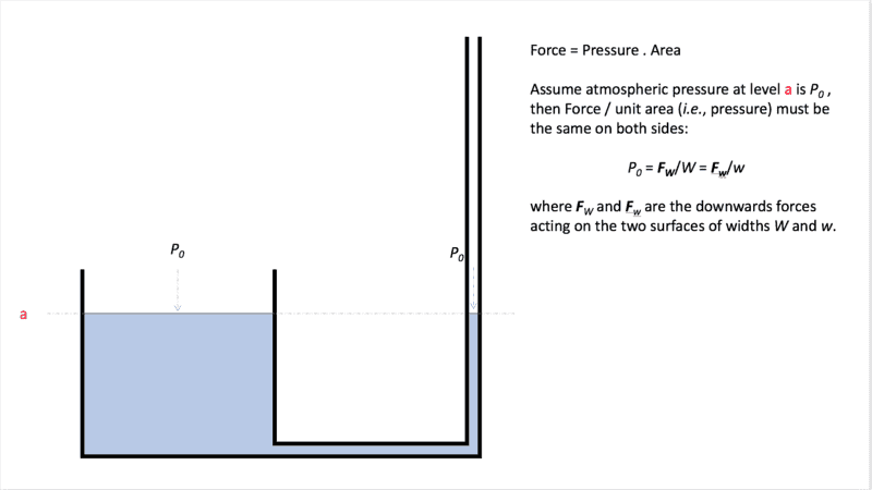

Diagram of a U-shaped tube with a wide left arm and a narrow right arm, partly filled with blue liquid to a level marked a, with P0 labelled at both open surfaces and text giving the pressure balance P0 = FW/W = Fw/w.

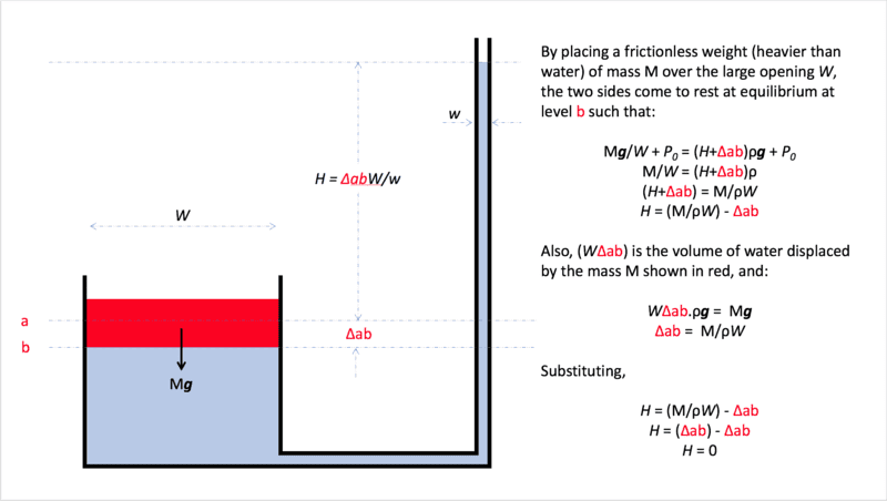

Consider a manometer as shown above with different widths W and w.
Diagram of a U-tube manometer with a wide left arm of width W holding water and a red mass Mg resting on its surface, and a narrow right arm of width w; height difference labelled H, Δab, with derivation equations in text at right.
If we take a mass (red) that is frictionless and does not allow water to leak of mass M, then I would like to calculate the height of water H in the narrow tube of width w. I arrive at a non sensical answer of H = 0 in one instance (and H = ΔabW/w) but I cannot see my mistake.
Your first expression, from the pressures, is almost correct. You should be using areas instead of widths, unless your tubes are rectangular and have the same depth into the page as each other.
Your second equation isn't correct. You should use the fact that the water volume cannot change.
@Ibix, you are right, I should have been more specific in stating this is a 2D (or a 2½D) model. To keep things simple assume the "volume" is always (area)*(unit depth).
In that case the "volume" of water displaced must give you H = Δab(W/w) as shown in my figure.
I cannot, however, see the problem with my logic using equal pressures at level b on the left- and right-hand sides. Should the correct equation be:
Mg/W + P0 = (H+Δab)ρg + P0 (as per my original post) or
Mg/W + P0 = (H+Δab)ρg/w + P0 ?​
Once I see what I am doing wrong, I will follow up with another question.

Ibix said:
It's the second one that isn't helping because the red mass is sitting on top of the water not floating in it.
This is good for me to hear. So, how should I treat the red mass if not floating?
If it is sitting on the water and we assume no friction and no leaks between the manometer wall and the red mass, is that different from floating? Does it still displace its own weight or is the physics different?
Should I treat it as a piston exerting a downwards force of Mg? In that case, must the pressures at level b (just below the piston) be equal on the left and right?
Your first equation is a correct equilibrium force balance on the mass. $$[p_0+\rho g (H+\Delta ab)]W-p_0W=Mg$$The first term is the upward pressure force on the mass, and the 2nd term is the downward pressure force on the mass. This is equal to the weight of the mass.

Great, so my equation
Handwritten equation: H = (M/ρW) - Δab, where H is height, M mass, ρ density, W weight and Δab a difference term.
is correct. It was my assumption (thanks, @Ibix ) that the mass M displaces its own weight that was incorrect. Here is my follow up question:

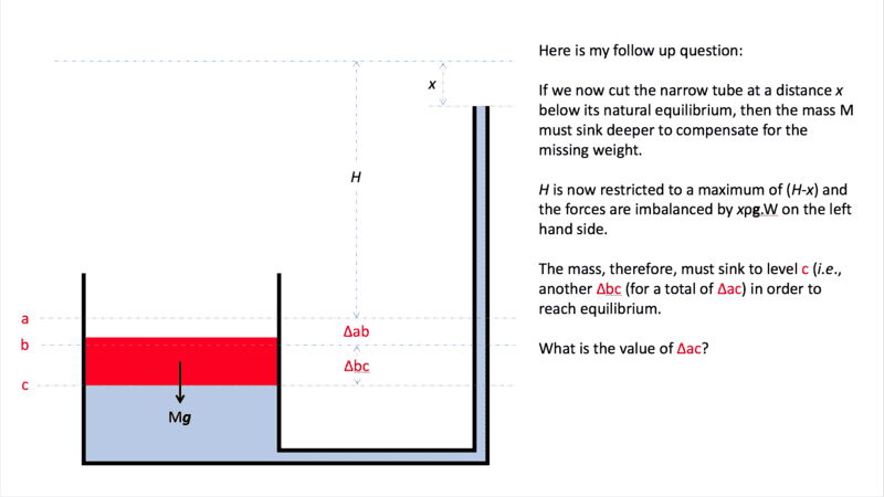

Diagram of a U-tube manometer with a red fluid column in the left arm, labelled levels a, b and c, a downward arrow labelled Mg on the piston, heights H and x marked on the right tube, and the question text beside it.
This was my follow up question but I think I have enough feedback to try and figure it out for myself. I would say that:
[p0 + ρg(H - x + Δac)]W - p0W = Mg​
and then solve for Δac .

This figure is not consistent with your original figure. Your definition of ##\Delta ab## has changed.
I don't know what you did here, but there is only one force balance, and you got that correct in post #7 (for the definition of ##\Delta ab## in your original figure). There is no other force balance required. As @Ibix points out, the only other equation needed is the conservation of mass equation: $$W(\Delta ab)=wH$$
Please look at my thread #9 for the diagram.
I cut a bit off the top (equal to x) and then defined the extra depth that the mass sinks as Δbc for a total of (Δab + Δbc) = Δac. It should be clear in the figure in #9.

The layout in the original figure is all that is needed to solve this. So let's, for the time being, stick with that. You have the force balance equation correct in post #7, and you have the mass balance equation I wrote in post #10. So you have 2 equations and 2 unknowns.

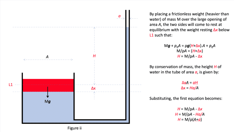

Diagram of a U-tube manometer: a wide left vessel of area A holds water with a frictionless weight Mg on the surface, top water level L1 marked in red, and a narrow right tube of area a rising to height H above the level L1 difference Δx.
Figure ii is what I postulated (using different terms and variables) and which was confirmed as correct.

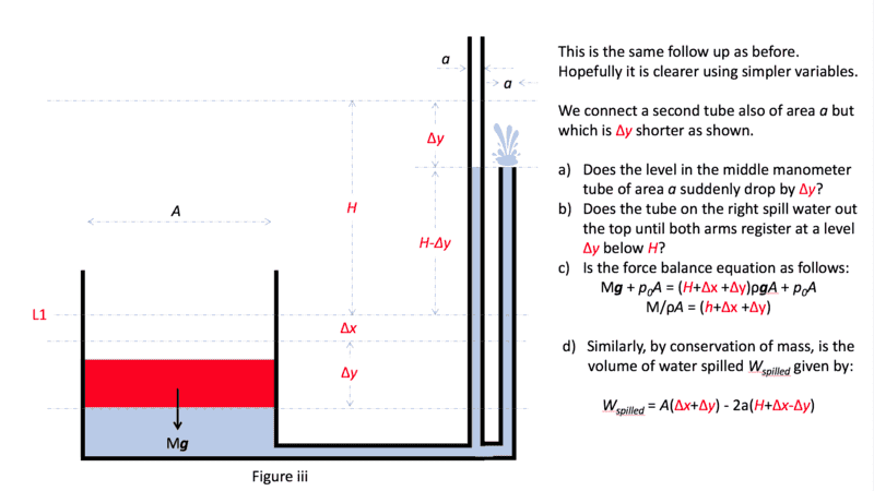

Figure iii: diagram of a U-tube manometer with a red piston-loaded block of mass Mg over water, labelled A, H, H-Δy, Δx, Δy, L1 and a, plus a second right-hand tube, with questions a) to d) and force and volume equations.
Figure iii above takes what I gathered from @Chestermiller and formulates the question using a variation of my previous lab set-up in order to help me understand the fundamentals better. My answers a) - d) attempt to answer my own questions but feel free (anyone) to comment.
Is the 2nd tube present initially and then just cut off, or is the 2nd tube connected (after the system in ii equilibrates), allowed to fill, and overflow?
In my mind, it is there initially at the same height as the one in the middle, the system equilibrates and then it is cut off by Δy.
Then the initial values of H and ##\Delta x## are different for this two-tube case. What are the initial values here?
I think what you are getting at is the conservation of mass that affects my H and Δx in Figure iii when compared to the results shown in Figure ii. If it makes it easier to remain consistent so we can compare, then let's change the areas a in each of the right-hand side tubes in Figure iii to (a/2). That works for my purposes.
Alternatively, we can leave the right-hand side tube as a and consider the middle tube as infinitesimally narrow and ignore any capillary and viscous effects. It is really the idea that the level in the middle tube drops while the right-hand level spills that I am trying to understand.
Please be clear which one you choose so it is easy for me (everyone!) to follow.
Let's go with a/2. In that case, the values of ##\Delta x## and H are the same as in ii. In iii, after the right tube is cut, does the vertical distance between the upper fluid surfaces on the right- and left sides change, or does it remain the same as before the right tube was cut?
Figure ii cf Figure iii: I get the same result if we go with a/2. The height H and value Δx must be the same in both figures.
Figure iii: In my solution I work out that if I cut either one of the two tubes on the right by Δy , then the whole system experiences a bulk shift of Δy resulting in the piston of mass M sinking by that further distance and the uncut tube also drops it's level H by the same amount.
This is correct. So, based on that, how much water leaks out?
(Δy.A)leaks out the right hand side tube
Δy is the drop in level in the uncut tube
In the simplest example, it seems to me that the height of the right hand column above the bottom of the metal plug is independent of the area of the right hand tube at equilibrium. The weight of metal is balanced by the water pressure times its area.
Cutting that extra tube short will put the plug at the same level difference and the longer tube just adds its volume to the amount displaced by the fallen plug.
