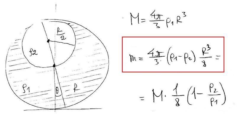

Hey guys.
Look at this one, I have a ball with density p1 and radius R. Inside the ball they dig another ball with radius R/2 and fill it up with material that has density p2. My question is, why does the mass "m" equals to what they wrote in the answer (marked with red)? why do I need to subtract the densitys in order to find the new mass?
10x.
  • Hand-drawn sketch of a large sphere of density p1 and radius R with a smaller sphere of radius R/2 and density p2 cut out of its upper part, touching the bottom at the axis; the right side shows the mass formulas M = 4πR³p1/3 and m = (4π/3)(p1 − p2)R³/8 boxed in red, followed by m = M(1/8)(1 − p2/p1).
M is the mass of a solid ball of density p1 and radius R. But you've cut out a ball of radius R/2 and replaced it with a different density. To find the new mass of the ball: subtract the mass you cut out (p1) and add back the mass you replaced it with (p2).

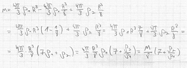

Still, this is what I got (in the pic).

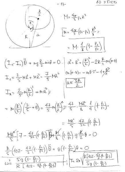

Ok, so do you know maybe what is that expression I marked in red could be?
Beats me. Where did you get it?
I assume that you've presented the problem accurately: Find the new mass of the large ball?
Oh, sorry, I forgot to post the entire problem...:blushing:
Anyway, they did what they did with ball, then, they put it on a surface with friction, diverted it a bit and then release (by a "bit" I mean that the angle is really small). the question is to find the period time T of the movement of the ball.
  • Handwritten physics derivation for a rolling sphere with a hollow cavity: a diagram of a circle with an inner circle of radius R/2 and angle θ, followed by equations for mass, moment of inertia, and the angular frequency ω and period T.
