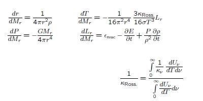

There are in fact equations that "build" a star (i.e. give relations of Pressure with Mass with Luminosity with Temperature with Radius), but they happen to be coupled differential equations which is quite difficult to solve, especially if you don't know all the parameters.
These equations are also, at best, approximations which simplify the stellar model a ridiculous amount. The equations assume hydrostatic equilibrium, no convective instabilities, and a myriad of other things. In short they are:
If you don't know what some of the symbols represent, just ask...but there's a lot of symbols so I won't be giving a full legend here.
As you can see...it's pretty complicated already, even with all the assumptions inherent in this model. For a full-fledged stellar model, computer simulation is necessary.
I am not aware of any simple relation such as M(L,T,R)=? I suppose you could just look at a few hundred thousand Main sequence stars, get their M, L, T, and R and get some empirical relations like those in posts above...that's probably the best way to go.
Thanks for the explanations. Now it's clear that the relations I was looking for doesn't exist at all. Well, such is life !
