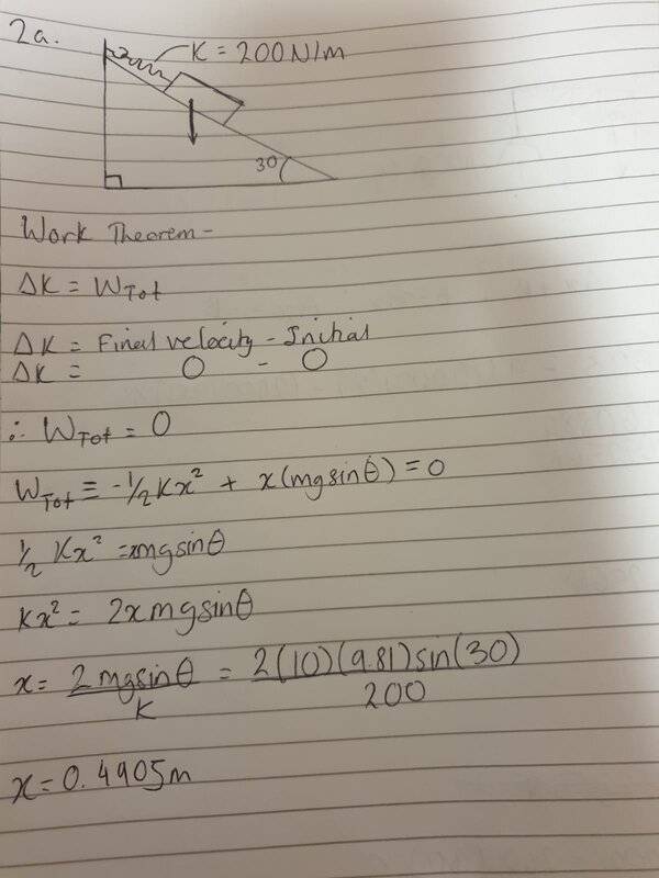

I did it and i get 0.5m for a) and 0.24m for b). used g=10m/s^2. Please post your workings here if you want me to comment on them.
I got x=2mgsin30/k and got 0.5 for a and 0.24 for b
Delta2 said:
Ok but better to show me your work in order to be sure what you did exactly.
Yea let me show you my working out
Ok, you did great, except one little thing, it is ##\Delta K##=final kinetic energy-initial kinetic energy, not final-initial velocity. Other than that everything looks good, because the initial and final velocity are zero, the same holds for the initial and final kinetic energy.
