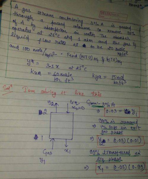

A gas stream containing 3% A is passed through a packed column to remove 99% of A by absorption in the water . The absorber operates at 25 degree Celsius and 1atm and the gas and liquid rates are to be ##20\frac{mol}{hr ft^2}## and ##100\frac{mol}{hr ft^2}##. Find the ##(NTU)_{OG}## , ##(HTU)_{OG}##.
Equilibrium relation: ##y^* =3.1x##
##K_x a##= ##60\frac{mol}{hr ft^3}##
##K_y a##= ##15\frac{mol}{ hr ft^3}##
In the given picture there is a question, I'm having huge confusion in finding out the mole fraction, I have put a solution to find the mole fraction in the picture, I know its wrong. This is where I'm stucked , I don't know the concept behind this . Please someone help me to get through this , where I'm wrong and what concept is used to find mole fraction in these questions or other varieties like this .

Let V and L be the molar flow rates per unit area (of column) of liquid and vapor. Let x represent the mole fraction of A in the gas phase, and let y represent the mole fraction of A in the liquid phase. Let ##phi(z)## represent the molar flow rate of A from the gas phase to the liquid phase per unit area of column at location z. Consider the section of the absorber between axial locations z and ##z+\Delta z##. What is the mass balance over this interval of A in the gas phase an of A in the liquid phase (in terms of the parameters identified so far)?

Here's my take on this. Let x* and y* be the concentrations of A at the gas-liquid interface. The liquid is flowing downward at rate L, and the gas is flowing upward at rate V. Let z be the vertical coordinate through the column. Let ##\phi(z)## the molar flow rate of A per unit height of column and per unit cross sectional area of column from the gas phase to the liquid phase. The mass balances on A are as follows:
$$L[x(z)-x(z+\Delta z)]=\phi \Delta z$$
$$V[y(z+\Delta z)-y(z)]=-\phi \Delta z$$
Taking the limit of these as ##\Delta z## approaches 0, we have:$$L\frac{dx}{dz}=-\phi$$
$$V\frac{dy}{dz}=-\phi$$
The interphase molar flow rate of A is related to the mole fractions in the liquid and vapor by:
$$\phi=K_ya(y-y^*)=K_xa(x^*-x)$$
The phase equilibrium relationship is $$y^*=Hx^*$$
Are you comfortable with this so far?

Yes sir
Do you know how to work with these equations to solve your problem?

If you'd like more help, I'll be glad to provide it. What is your first step in the solution to this problem?

Thank you sir , I got this now .
First I take initial basis for both the flow rates , I took 100kmol for the gas phase and 500kmol for liquid phase observing their flow rates , and then I calculated the mole fraction of solute in both entering as well as leaving stream from the given information and solved further using equilibrium relation.

Excellent!
