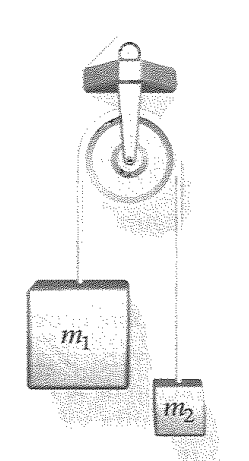

An Atwood's machine uses two masses ##m_{1}## and ##m_{2}##. Starting from rest, the velocity of the two masses is ##v=4\,\mathrm{\frac{m}{s}}## after ##3\,\mathrm{s}##. In that instant, the kinetic energy of the system is ##E_{k}=80\,\mathrm{J}## and each one of the masses has moved ##6\,\mathrm{m}##. Calculate the values of ##m_{1}## and ##m_{2}##

I've tried to solve this exercise but I haven't used one of the properties of the system (the displacement of the masses) so I don't know if I'm wrong about my procedure.

So, am I right or did I do something wrong? The only thing that I really doubt about my procedure is the fact that I assume that the net force is ##F=a(m_{1}+m_{2})## but still I'm quite insecure.
Here's the diagram btw
You cannot use P = E/t since the energy put into the system varies with time. In particular, at t=0 the velocity is zero so P = Fv is zero for both masses.
You have already found that ##(m_1+m_2)a=(m_1-m_2)g## where ##a=\frac{4}{3}~##m/s2. That's one equation relating the masses.

While that is true, and is certainly worth pointing out for future reference, it does not appear that @Venturi365 used ##P=Fv##. Rather, ##\frac 12mv^2=E_k## was used to find the sum of the masses and ##F=ma, a=v/t## were used to find the difference.

Seems to me that is what @Venturi365 did. The question is why the info re the distance moved was not needed. The solution to that is that, assuming constant acceleration, it was redundant: average velocity ##=\frac{u+v}2=\frac st##, ##\frac{0+4}2+\frac 63##.

I agree. The two relevant equations that OP already has are
##m_{1}g-m_{2}g=m_{1}a+m_{2}a##
##m_1+m_2=\dfrac{2\Delta K}{v^2}##.
In this form one can solve the second equation for one of the masses and substitute in the first. The displacements would be needed if the second equation were written in terms of ##h## and ##\Delta U = -80## J. In that case, the speed would not be needed.

It's right that I started with one statement and ended up forgetting it, I apologise for that. However, this means that I didn't commit any misconception, right?
It appears that you had a misconception, but did not rely on it in your solution.
