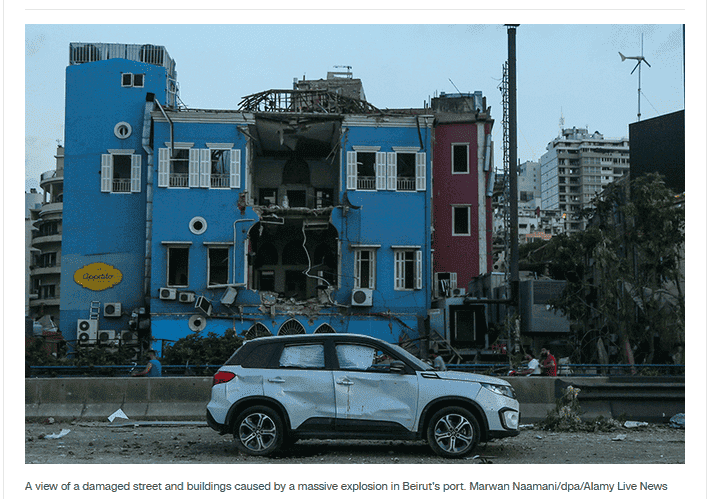

Wow. What two things do you notice about the vehicle parked in front of this damaged building?
https://www.cnn.com/middleeast/live-news/lebanon-beirut-explosion-live-updates-dle-intl/index.html
The side is dented in, and it looks like the side airbag curtains have gone off. Wow.

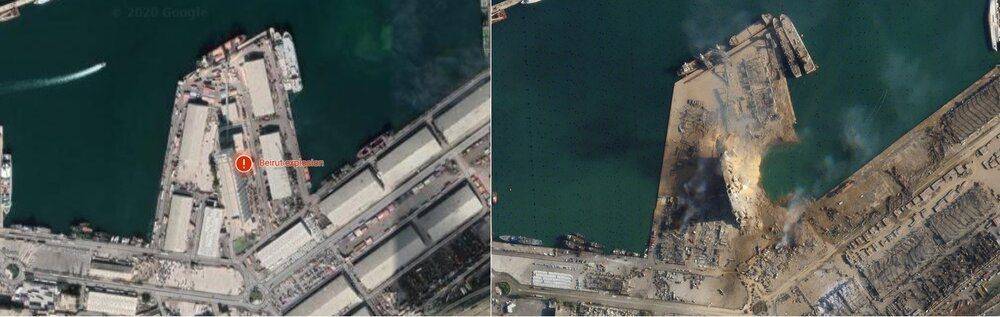

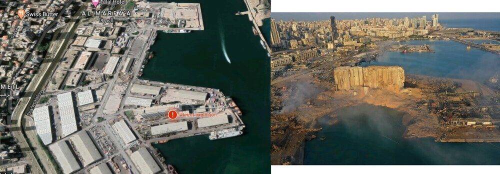

In looking at the two pictures, at first I was thinking, "No, that looks to be a different part of the port. The shape of the water inlet looks different." And then I realized that it's because of the giant hole in the ground from the explosion that is now filled with water. Yikes!Borg said:Here's a before and after.
