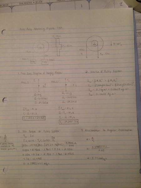

The ropes in the figure are each wrapped around a cylinder, and the two cylinders are fastened together. The smaller cylinder has a diameter of 10 cm and a mass of 5.0 kg; the larger cylinder has a diameter of 20 cm and a mass of 20 kg. What is the angular acceleration of the cylinders? Assume that the cylinders turn on a frictionless axle. I know the answer is 3.5 rad/s2.
Figure: http://session.masteringphysics.com/problemAsset/1176936/5/P7-59.jpg
[itex]\alpha[/itex]=τ/I
τ=rF
I=1/2*M*R2
I tried calculating the net torque of the cylinders caused by the hanging masses. I then divided the net torque by the total inertia on the cylinders using the first equation listed above.

That overlooks the inertia of the two hanging masses. Safest is to assign a tension variable to each rope, an angular acceleration variable for the cylinders, and write out three free body equations.
I think it may be easier to post my work than trying to explain it. This is what I have done, and I am unsure where my error may be. Any help is greatly appreciated!
Easier, but very hard to read.
The acceleration is not the same for both blocks.
