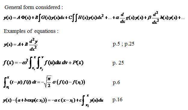

Some exemples of various forms of differential equations and integral equationsare provided (attachment)
  • Typeset list of integral and differential equation forms with page references: general form y(x) = AΦ(x) + B∫G(x)y(x)dx + C∭H(x)y(x)dx² + ... and examples including y(x) = A + B d²y/dx², f(x) = −ω²∫∫f(u)du dv + P(x), and an integral equation on pages 5, 25, 6 and 16.

I really don't have the need to go into linear integral equations. So,if you could please explain in a gist what you are trying to do with integral equations and how it could help with the regression,that would be helpful!
The referenced document deals with differential equations and/or integral equations.
In your case, only differential equations are considered. So, you don't need to consider the integrals appearing in the paper, but only the differentials.
As explained, from a given data, it is possible to compute the coefficients of a differential equation in order to obtain an optimized fitting between the solution of the differential equation and the given data.
As it is written in my first answer, I am aware that this paper is not excatly in the scope of what you are asking for. Nevertheless, I hoppe it will suggest you a new way of search.

I understand that the aim of this paper is the to eliminate the need of recursive iteration process in nonlinear regression,which intern means this method eliminates the need to choose an initial condition as close to the real solution as possible. Am I right?Could you send me a program code and I could have a more visual understanding.

Quite right. In fact, the aim of the paper is to show how one can transform a non-linear regression problem into a linear regression problem (not always, but in some cases). Since a linear regression doesn’t need recursive process, the consequence is that the transformed non-linear regression non longer needs a recursive process. That is an advantage of the method, but there are some drawbacks.
Several examples of very simple algorithms are shown page 7, 17, 19. One can easily write them in program code. These examples correspond to the cases of integral equations. On can understand what are the similar algorithms in cases of differential equations ( i.e. : computation of D_k instead of S_k , page 3).
I have no ready made code in case of differential equations because, in practice, I mainly treated some cases of integral equations. As it is explained in the paper (with an example page 27), the method is more reliable for the fitting of the integral equations than for the fitting of the differential equations.
