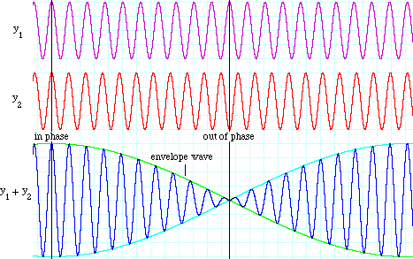

Have a look at the Interference beats and Tartini tones page for the math.
There are ".wav" sound files of beating sine waves you can download and/or listen to plus interactive video clips.
This is just one page from http://www.animations.physics.unsw.edu.au/

but how do i make a beat for 4 Hz that goes down to 0 ? and not just close to 0 ?
so like F(t) = 10 sin( π * 180 * t / 44100 ) + 5 sin( π * 184 * t/44100)
how different should the Amp how to be to get 0 ?

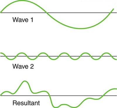

btb4198 said:
F(t) = 10 sin( π * 180 * t / 44100 ) + 5 sin( π * 184 * t/44100)...
Now I think I kinda see what you're asking.
The coefficients of the two waves are not equal in this case (10 and 5), so the resultant will look something like this.
Image compliments of http://cnx.org/content/m42249/latest/
Here's an interactive applet that will show how this works.
http://www.eserc.stonybrook.edu/ProjectJava/WaveInt/index.html

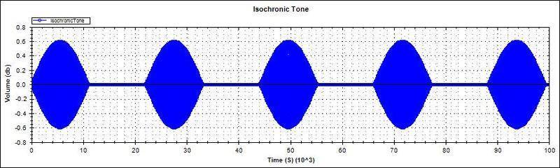

I am tying to make an Isochronic tones. " are regular beats of a single tone used for brainwave entrainment. Similar to monaural beats, the interference pattern that produces the beat is outside the brain so headphones are not required for entrainment to be effective. They differ from monaural beats, which are constant sine wave pulses rather than entirely separate pulses of a single tone."
http://en.wikipedia.org/wiki/Isochronic_tones#mediaviewer/File:Isochronic-toes.svg
The picture make it look like it drop down to 0 during the beat. I am trying to get a to do that without any tickles ... and I have trying fating in but that is not working... I still get a tick.
does anyone have an Isochronic algorithm?
I have been looking everywhere and I can't find one...
the only useful information I found on it, is from that wiki and as you can tell it is not that useful ...
Baluncore and meBigGuy do you understand what I am asking now ?

See the attached is a 44 Hz tone in a 4 Hz envelope
Yes, but are you happy with it ?
Baluncore
yes, it sounds like the other file I posted. so that is good. sorry I am new to this...

The original problem with understanding your requirement was because you referred to a “beat” as generated by the addition of two sinewaves, rather than the product of one sinewave by an envelope function.
The sine() and cosine() functions repeat every 360° or 2*Pi “radians”. That is one cycle.
One hertz, Hz, = one cycle per second, = 2 * Pi radians per second.
http://en.wikipedia.org/wiki/Radians
Notice that I get four bursts of tone per second for Hz = 4 in my code, the frequency is calibrated. I suspect you may be out by a factor of two, which is one musical octave. That may be because you did not initially understand mathematical angular measure, where 2*Pi radians = 360°.
The code I posted was not in any particular language, it was a way of writing a mathematical algorithm, in a cross between BASIC and FORTRAN. I do not like C { }.
btb4198 said:
also how did you know it should be a trapezoidal waveform ?
and how did you come up with your code ?
Experience. It must be a slow rise-time trapezoidal envelope to reduce the clicking sound of high frequencies present in a sudden step. I used part of a sine wave for the envelope because it was the easiest quick fix that would give control of the burst rate and envelope. There are other slightly better sounding solutions. I could see what was required by looking at your wiki link in post #13. I have been receiving and analysing RF signals that look like that for 35 years. My code was minimised because I avoided the complexities of implementation. I presented just enough code to show how the math works.

1) Before w = 1 do you have to do a(t) = w * Sin(theta * Hz)? Could you just do a(t) = w and then at w = 1 do a(t) = w * Sin(theta * Hz)? And at w =0 , a(t) = 0, or would that cause distortion in the waveform? Thinking about it now I think it might cause distortion, right? Because, you would be switching from one waveform to another? (Sorry, I am new to this).
2) I did (1/4Hz)/(1/44100Hz)
4hz being my beat
44100 Hz being my sampling rate
and I got 11025 samples. Meaning that is where the 0s should start and in Excel it did ! I got 3.67545E-16 with is 0 at the 11025 sample. so my question is this, I used 3 * SIN(C2 *PI() * 4 / 44100) and not 3 * SIN(C2 *2*PI() * 4 / 44100) and it seems to be right, so why is the 2 not working? When you read about waveforms online and in school they always have (2*pi* f) but when I use 2 I get the wrong information. I have an fft and when I would use the 2 I would get double my f. so why is that?
3) How did you come up with your K again? Is K the RMS value? K is Gain right?
4) What is an envelope function?
4) The envelope does not have negative values so when it is multiplied by the tone it does not invert the tone. Effectively it amplitude modulates the tone. You need to plot the graph of the envelope function alone, then with the tone, so you can see how it all works. It is not something you can do in your head or a list of double precision numbers.
3) A simple sinewave has a slope of +/- 1, (per radian), as it crosses the x-axis. Multiplying by 3 steepens the crossing. Once it is steeper, I can throw out the negative part by clipping it at zero, and give it a flat top by clipping at 1. There are many possibilities for the envelope function, you could try something like w = 0.5 * (1 + Sin(2 * Pi * Hz / samples_per_second) ). That will have values of from 0 to 1.
2) I can't debug the code hidden in your computer. You must find out what is happening by plotting simple graphs such as a single cycle of a sine wave, then look at the picture and experiment. The factor of 2 time scale error will be a really simple bug, question everything fundamental that you trust. Questions you should ask are:- How long in time is the signal you generate? How many points do you generate? Are you generating (samples_per_second * seconds) data points?
1) You should plot the w value as a graph so you can play with the algorithm and see the effects.
