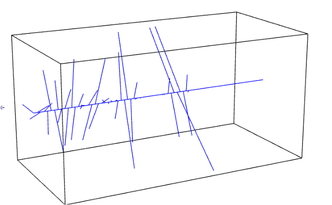

And another question, if I may: I have used ListPointPlot3D to show some complex numbers as a function of some ##t## that goes along the length of the box:
3D plot in a wireframe box showing many blue line segments that run roughly vertically, with a long blue line running horizontally through the middle, rising slightly from left to right.
However, the Filling->Axis doesn't help here because it sends each line downwards rather than towards the ##t## axis.
I had to doctor the data and insert ##0 + i0## before and after each complex number to get the above plot -- so ListPointPlot3D is probably the wrong type of plot for this.
What is the best way to do this?
