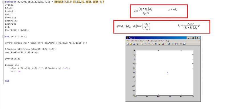

Attahced is my short MATLAB script, I am basically trying to use iteration to plot 2 sets of 2 functions to see where they intersect, all other information in the script are constants. attached also is the incorrect graph that i get
flux = F
If = Ifield
Any help would be appreciated

You plotted a few points instead of each function.
The way you've defined everything, there are no variables. Everything is a constant, which is why you only get points. Should you be varying w to plot each function?
Also, if you just want to know where the two functions of the form m = tanh(m) intersect, you can also plot m-tanh(m) and use fzero() to find the zero where they are equal.
