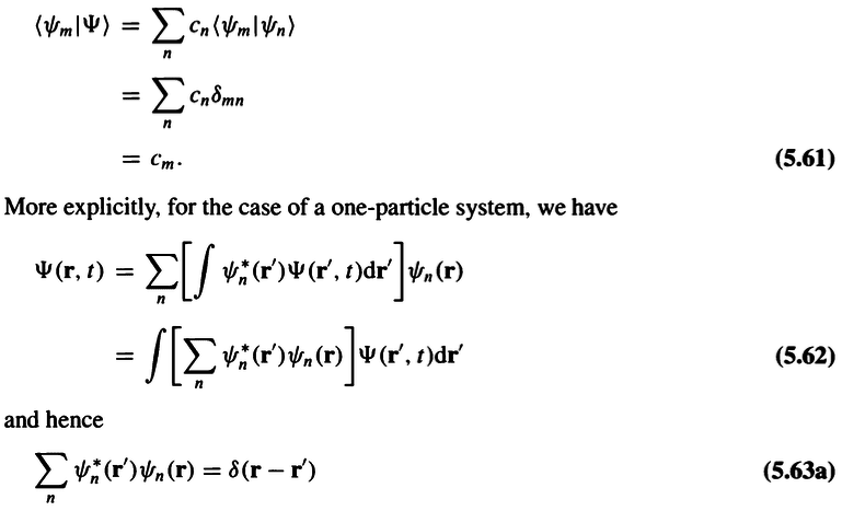

By the closure relation (5.63a) below,
##=\int\phi_m^*(r)\,A\big(\int\sum_l\psi_l(r)\psi_l^*(r')\phi_n(r')\,dr'\big)dr##

Derivation of the closure relation (5.63a):

Use
[tex]\sum_{i}\psi_{i}^{*}(x)\psi_{i}(\bar{x}) = \delta (x-\bar{x}) ,[/tex]
to write
[tex]\phi_{m}^{*}(x) = \sum_{i} \int d \bar{x} \ \psi_{i}^{*}(x) \psi_{i}(\bar{x}) \phi_{m}^{*}(\bar{x}) ,[/tex]
[tex]\phi_{n}(x) = \sum_{j} \int dy \ \psi_{i}^{*}(y) \psi_{i}(x) \phi_{n}(y) .[/tex]
Now, substitute these in
[tex]\langle \phi_{m}|A|\phi_{n}\rangle = \int dx \phi_{m}^{*}(x) A \phi_{n}(x) ,[/tex] and rearrange the factors
[tex]\langle \phi_{m}|A|\phi_{n}\rangle = \sum_{i,j}\left( \int d\bar{x} \phi_{m}^{*}(\bar{x}) \psi_{i}(\bar{x}) \right) \left( \int dx \psi_{i}^{*}(x) A \psi_{j}(x) \right) \left( \int dy \psi_{j}^{*}(y) \phi_{n}(y) \right) .[/tex]
This, you can write as
[tex]\langle \phi_{m}|A|\phi_{n}\rangle = \sum_{i,j} \langle \phi_{m}|\psi_{i}\rangle \langle \psi_{i}|A| \psi_{j}\rangle \langle \psi_{j}|\phi_{n}\rangle .[/tex]
