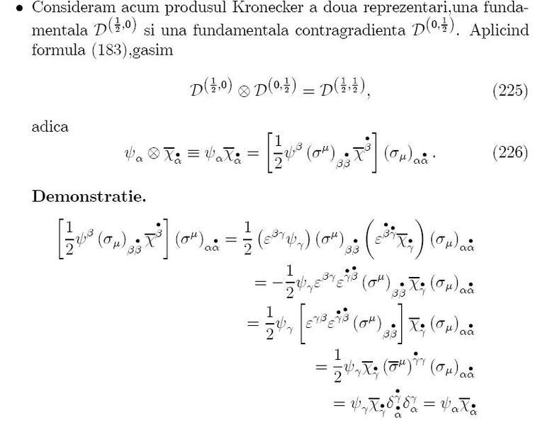

They are not the same thing, but related, and you can see it because the (1/2,1/2) spinor is a scalar from the point of view of SL(2,C), because it carries no free Weyl index. I have attached the calculation. The 'object' in the squared brackets is the 4-tuple. So it's a 4-tuple of numbers which form a genuine 4 vector and can be placed in a matrix either as a column vector, or as a 2x2 matrix with the Infeld-van der Waerden symbols.
Thanks for the pics dextercioby, but i don't know the notation you use (as well as the language)
The thing that confuses me is that i know that the [itex]\tau_{mn}[/itex] are the representation of the lorentz group, but i cannot see them as spinors/vectors!
The spinors are the things that [itex]\tau_{\frac{1}{2},0}[/itex] (or [itex]\tau_{0,\frac{1}{2}}[/itex]) act on!
