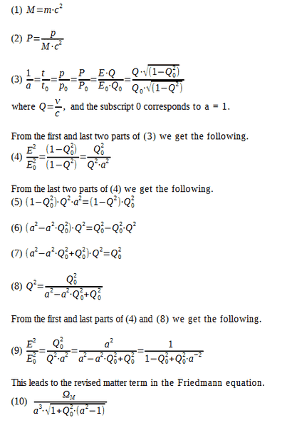

It has occurred to me since May 2015 that for certain purposes the matter term in the Friedman equation might benefit from a modification.
The Friedmann equation
shows the matter term to be based on the assumption that the particles of matter never acquires any significant kinetic energy. One example for which this assumption is inadequate is calculating the affect on the solution t(a) by assuming DM consists of particles with small mass. In 1998 the idea that neutrinos might be the stuff of DM was an active possibility.
Apparently it is still active at MIT.
However, I have been unable to find any articles discussing the effect on t(a) based on modifying the mass term, even though the corresponding change in t(a) could have a significant impart on the primordial nucleosynthesis of deuterium.
To evaluate this possibility, the first step would seem to be to find the appropriate revised function F(a) to replace
F(a) = a-3​
as the coefficient of ΩM. I would much appreciate if one or more participants of PF would check my math and post descriptions of any errors they find, or to acknowledge that they found none.
The mass term in the Friedmann equation that I derived is:
It is clear that for a = ε << 1:
Q02 << 1, and F(a) ≈ a-3.
Also, for 1-a = e << 1:
Q02 ≈ 1, and F(a) ≈ a-4.
The following is the derivation of the modified F(a).

Hi @Chalnoth:
Thanks very much for responding. Also, thank you for making it clear to me that neutrinos are no longer considered to be a significant kind of DM. I have been unable to find anything definitive on this point searching for the past two years. Can you cite a reference for me?
I have the idea the using the modified F(t) it would be possible to estimate a lower bound for the mass of a DM particle that would make up a significant portion of DM. To make this calculation I would need an estimate for a temperature at which these particles would be in equilibrium with photons. Can you help me with that?

Hi Peter:
I think I may have a misunderstanding about terminology.
My concept of "matter" as it pertains to the matter term in the Friedmann equation (FE), is that matter consists of particles that have some kinetic energy V, and typically V << mc2, so it is ignored in the FE. However, for very small values of a, and corresponding high temperature K, the particles becomes relativistic and then it behaves like radiation. When solving the FE to calculate numerical values for H(a) and a(t) when t0 >> t something must be done to deal with the transition regarding the particles which comprise the matter term when it is in between being a non-relativistic particle and a relativistic particle.
A somewhat simple approximate way to do this would be to use an intermediate value of t, say ti, such that for the particle at a(ti)
V = mc2.​
For
t=ti
set
revised Ωr ⋅ a-4 = Ωr ⋅ a-4 + Ωmp ⋅ a-3
and
revised Ωm ⋅ a-3 = Ωm ⋅ a-3 - Ωmp ⋅ a-3 .​
The adjusting term
Ωmp
is that portion of Ωm corresponding to the particles with mass m.
However, I think a cleaner way to make the adjustment is to calculate Q0 for the particle and use the form for F(a) I derived in post #1. If there are several different kinds of particles with different masses, each would have it's own value for Q0, and in the FE each different kind of matter would have its own term. Do you see anything wrong with using this approach to get a more accurate calculation of t(a) for very small values of a?

Hi Peter:
What I am interested in exploring is just how much the calculations of, for example t(a), would be affected by assuming DM consisting entirely of a particle type with a specific relatively small mass and corresponding small but non-negligible kinetic energy. It may well be that no value for this mass would lead to any significant changes, but I would like to make the calculation to understand why this is so. The purpose of this thread is to seek help to confirm that the form of F(a) I derived would be a mathematically correct way of adjusting the FE for this purpose. If the math is OK, but the physics is wrong, what other form of the FE would be better to use for this purpose?
In other words, not zero pressure ("matter"), not ##p = \rho / 3## (radiation), but something in between?
This is verging on personal speculation, which is off limits. But heuristically, such a hypothetical "in-between" substance would, I would think, appear as a separate term in the equation, with its own ##\Omega## (and picking a new subscript), multiplied by a power of ##a## somewhere between ##-3## and ##-4##. I would suggest looking at the literature to see if anyone has tried such a model.
This thread is closed as it appears to be verging on personal speculation.
