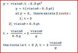

I understand how to derive the equation for the range formula. What I don't understand is that the g in the equation was not specified as a magnitude so why should I be using the magnitude and not the vector g?
So, in the derivation, what is the exact expression for the vertical position at time ##t##?
I have understood why g = 9.8 instead of -9.8ms^-2
Good. It is because the equation for the vertical displacement explicitly includes a negative sign before ##g##, i.e. ##\displaystyle y = v\sin\theta{t} -\frac{1}{2}gt^2##. Hence ##g## here refers to the magnitude only.
