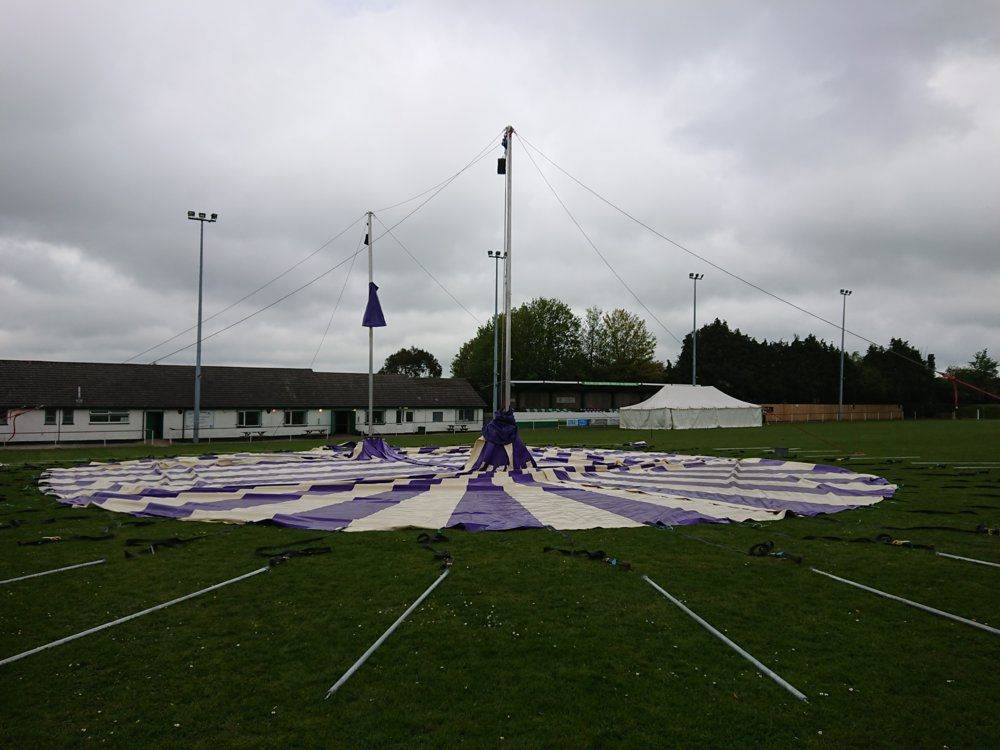

I'm planning on making marquee poles out of aluminium tube. I did so last year and they worked well, but they flexed slightly under tension.
To correct this flex, I want to use slightly different size of aluminum tube.
I used 4" tube, with a ¼" wall, at a length of 30'.
Will the tube be stronger with a larger diameter, or do I have to go for a larger wall thickness?

What's a Marquee Pole? And why would it flex under tension? Don't you mean some sort of bending stress?
Can you post pictures of your previous poles? Use the Attach files link below the Edit window to upload PDF or JPEG files. Thanks.
Marquee poles, or big top poles. Tent canopy pole.
I've attached an image of the poles as they're set up, ready for the tarp. They're anchored with guy lines to the top of the pole, and we use a winch to hoist the tarps up the poles.
Hope this is better information.
Ah, thanks. That helps.
But what did you mean about flexing under tension? Do you mean they flex if the rope tensions are uneven?
Who insures the installation of these tents? What wind loading do you need to design for? Where are these tents used?
Are there other commercially-available tents like these? And what pole construction to they use?
by flex I mean a slight bow in the full length of the pole if the tarps are over tightened, or hoisted too high. The wind loading is 65mph. The pole construction varies from company to company, steel is one option, wood another, aluminium also. We have used aluminum because of the weight reduction.

I think you mean that the poles flex under compressive load, rather than tensile load, right. Also, I think you are referring to the stiffness of the poles, not their strength. Strength usually refers to the conditions under which the material breaks.
Yes I agree, my terminology is not as good as it could be. I am more of a hands on person and this is all a bit technical for me, but I'm learning!
Yes, it's the flex when the poles are put under tension. And the stiffness, I guess that is what I need to increase to reduce this flex...?

For a given material, the thing that determines the flexural rigidity of one of your tubes is its moment of inertia about a centerline. For a given economics, the moment of inertia should be as high as possible. The moment of inertia is a function of the tube diameter and the wall thickness. Google formulas for moment of inertia of various beam cross sections.
