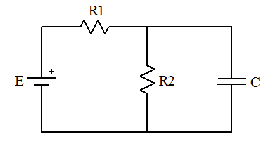

a) Determine the time constant for charging the capacitor in the circuit given.
b) what is the maximum charge on the capacitor?
R1
______vvvv____________
E R2 > C
|______________|______|
E = emf and C is the capacitor, sorry for the poor illustration.
Mentor's edit: Here's a better illustration:
For a, I've determined the equivalent resistance of parallel resistors to be (1/R1 + 1/R2)^-1 = R1R2/(R1+R2), thus the time constant would be tau = CReq = CR1R2/(R1+R2)
For b) I have a feeling Qmax for the capacitor will be Qmax = CV where V is the voltage across R2 since R2 and C are parallel, but I can't figure out V across R2 in terms of E, R1, R2, C. Can anyone help? Thanks again.
I got the same result after solving with differential equations.
Let the time constant be T.
Current supplied by the source is,
I(t)=ET/(R1R2C)*(1-e-t/T)+(E*e-t/T)/R1
From this equation, it can be verified that at t=0, I=E/R1(capacitor acts as a short at t=0) and at t=∞, I=E/(R1+R2)..(capacitor acts as open circuit at t=∞).
In steady state, the capacitor will act as an open circuit. Hence, current will flow though the series combination of R1 and R2.
So, Voltage across C=Voltage across R2 in steady state= E*R2/(R1+R2)
Final charge on the capacitor=Q=CV= ECR2/(R1+R2).

The above approach involves some mathematical calculations and a generalized expression for current I(t). Instead, I believe the best and simplest approach to solve these two questions a and b is Thevenin's theorem.

Why do you regard R1 and R2 as being in parallel?
When C is fully charged then the current through the capacitor is ?
Which makes the fial voltage across C ? ?Hence the max charge will be ? ? ?

Vc=VR2 where R1 & R2 are voltage divider.
I = E/(R1+R2) and VR2=IR2, so Vc =E[R2/(R1+R2)]
Since C=Q/Vc, Q =C Vc, so the charge Q depends on the value of capacitance you put on your circuit and magnitude of Vc
