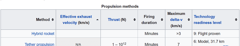

So I was browsing wikipedia when I encountered:
Table titled Propulsion methods with columns for method, effective exhaust velocity, thrust, firing duration, maximum delta-v and technology readiness level; rows include hybrid rocket and tether propulsion.
What does this exactly mean? How does one calculate for this?
<< Adding link to the table >> https://en.wikipedia.org/wiki/Spacecraft_propulsion#Table_of_methods
mfb said:
Find the exhaust velocity, then make reasonable assumptions about the dry mass fraction and use the rocket equation.
So it's more or less an estimate?

Note that tether propulsion does not conform to the rocket equation at all.
For hybrid rockets, the mass fraction is critical, as in most cases a solid fuel is burned using an injected oxidizer.
The fuel loses integrity once 80 or so percent have burnt, which kills the mass fraction.
