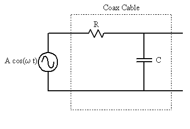

Signals from sources of different kinds are often very weak and very quick. To minimize the noise risk they're often led through coaxial cables. How long can one [coaxial cable] be if it has the capacitance 80pF / m and resistance 0.04 Ohm/m and you want to transfer noise that varies on 100 nano seconds?
time constant = RC
Right, so have the solution which basically just outlines what you do. You find the length L so that t is less or equal to RC. The cable is regarded as an RC circuit.
But I don't get the physics at all, what am I actually looking for? Noise that varies on 100 ns? (It's a direct translation but I honestly don't understand it better in my native tongue). What's special about t < RC in this scenario?

It's an exam question from an old exam. Course is basically forcing us to make simplified models of pretty much whatever asked, should probably have specified that. ie if you can't calculate it with the information given you make do with what you have.
Still don't understand it.
Presumably you're meant to model the coax as a simple RC filter.
The input signal has frequency components that have a period on the order of 100 ns. What angular frequency ω does that period correspond to? That frequency will specify your filter cut-off (corner) frequency...
Solution doesn't even touch on the cutoff frequency or anything of the sort though. It does nothing except plays around with the time constant, I mean the actual mathematics involved is as elementary as it gets and. He puts the RC constant to 100ns.

I disagree with the given solution. The corner frequency of an RC low pass filter is
$$f_c = \frac{1}{2\pi \tau} = \frac{1}{2\pi R C}$$
Yes it involves the time constant ##\tau##. But there should be a factor of ##2\pi## in there!

I thnk the meaning is you want a 1st-order low-pass filter (R-C network) with cutoff radian frequency w = 1/(RC) where RC = 100 ns.
So, let x = length of line, then R = 0.04x and C = 80e-12x. Solve for x.
