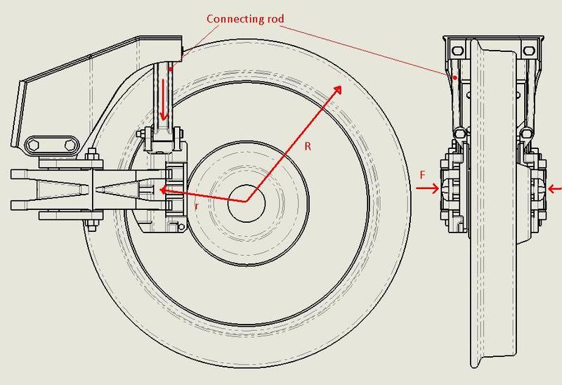

what is the down force on the connecting rod?
i tinnk I've work most of it but I'm a bit unsure of what to do next?
A train of mass 138800kg
have 24 wheels (12 axles)
V = 37.1 m/s
U =0
s= 694 m
F= 12.1KN
R = 0.4 m
r = 0.21 m

Were is this braking force atchley acting on the wheel ( at the rim the edge of were?)
when the force F is clamping on the wheel the force from the wheel will transfer to the rod?
I think you have done wrong.Here you need to check torques as it is not point object but a rigid body.
i did think torques but all i can think is t = f x r
so is this 5.7 x .21 =1.194 KN/M
Whats that in a straght down force on the rod?
Yes it's tangential force.And both torques will get added.
sorry what do you mean by both will be added?
connecting rods touch disc at two points at r, and R.One is anti-clockwise torque and other is also anti-clockwise.So both get added.That's what it seems if you have both rods touching disc to brake it down.It seems unclear here.Though you haven't stated it here that only one rod touches disc or both do.
sorry for my unclear pic.
r is the distance from the center of the wheel to the point which the rod acts
R is the effective wheel radius.
the top of the rod it fixed to the braking braket.
the down force on the braket is what is needed?

Maximum press exerted on the disk by the brake pads: μ×F_Pad = R/r × F_Wheel/2
= 0.42/0.21 × 5.7/2
= 12.4 KN
