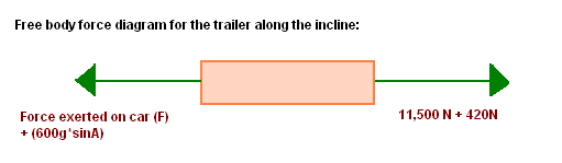

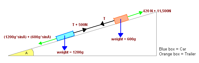

You need to draw a free body diagram of the trailer to identify all the forces acting on the trailer along the incline (the tow bar is not in tension as you have indicated). Then apply Newton 2 to the free body diagram of the trailer.
Jay, is this diagram okay?
How do I apply Newton's second law of motion to this? From the diagram, I know that the resultant of all the forces [i.e. 11,500N + 420N - F - (600g*sinA)] causes the trailer to decelerate at 6.2ms^-2 down the incline.
You are not drawing your free body diagram (FBD) correctly. The problem asks for the force exerted on the car by the trailer (which is the force in the tow bar). By Newton 3, the force exerted on the trailer by the car is equal and opposite to that force. It is simpler to look at the FBD of the trailer. You must identify the forces acting on the trailer parallel to the incline. The braking force does not act on the trailer. Only the tow bar force, the parallel component of the trailer weight, and the 420 N resistance force act on the trailer in the direction parallel to the incline. Apply Newton 2 to this FBD to solve for the tow bar force, making sure to use the mass of the trailer and the known acceleration in your calculations. Alternatively, you could look at the FBD of the car, and achieve the same result for the tow bar force.
Thank-you so much for your help, Jay :) I understand this problem now. My exams in a few hours, so here's hoping that I'll do well :)
Basically it came down to:
F - 420 - (600g*sinA) = Mass x Deceleration
F = 3720N
That's F + 420 - 600gsinA = (600)(6.2) =3720
F + 420 - 420 = 3720
F = 3720 N
The tow bar force and resistance force act up the plane.
It's a coincidence that the weight component and resistance force have the same value.
