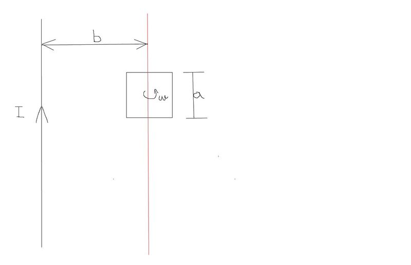

In the very long wire conductor as shown on the picture , flows a current magnitude I. Near the wire there is a
square shaped contour , with length a ,which rotates around its axis a constant angular velocity. Axis of square contour and a straight line conductor are parallel , and the distance between them is b = 3*a / 2 .
Environment is the vacuum. Find the expression for the maximum value of induced EMF e(t) induced in the contour. Ignore the self-inductance emf.
Solution e max = 3*u (zero)* I * w * a / 10*pi
upload pic

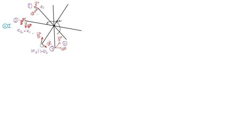

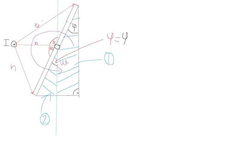

I can't find relation between theta 1 and angle fi

Yes, but it is rotating. The diagram is a view along the axis of rotation at an arbitrary time.
@Ivan Antunovic , in your diagram, draw a vertical line through the middle of the frame. What parallel lines do you see?

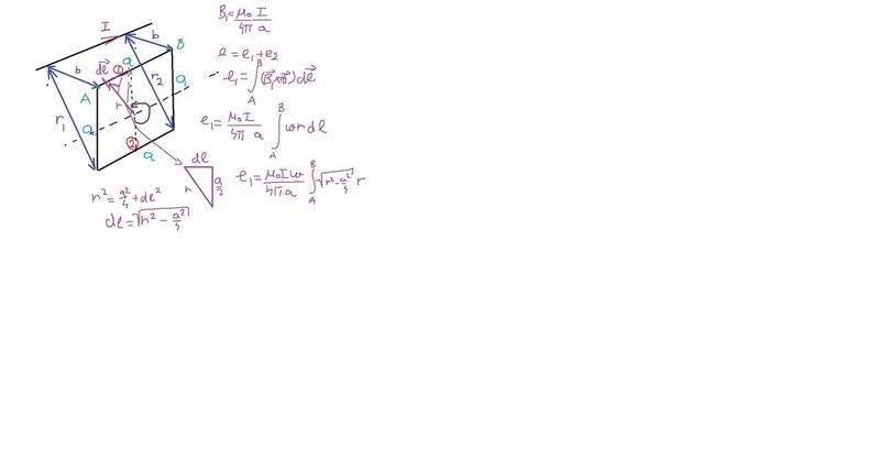

Yes you are right it's rotating , @drvrm I am sorry if my diagram was bad , I tried my best.
@haruspex I drew vertical line and I see two triangles that are blue triangle 1 and blue triangle 2 similar and that they have both the same angles.If that was your point?

Hope that is what you meant.

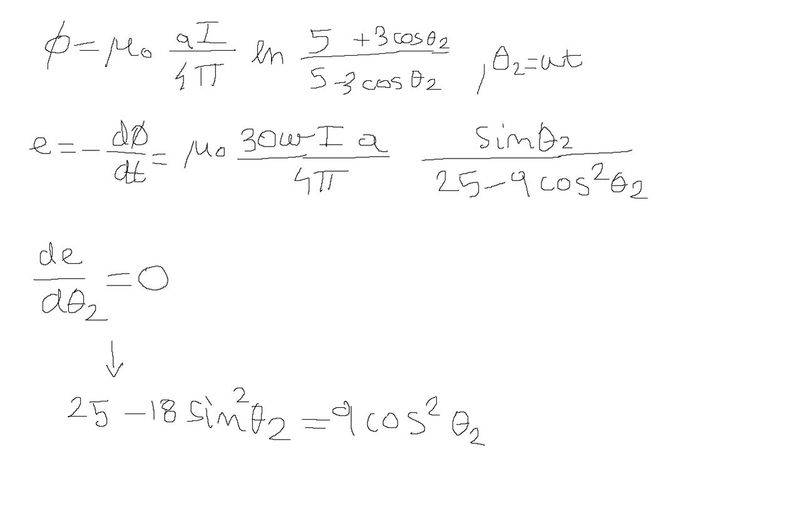

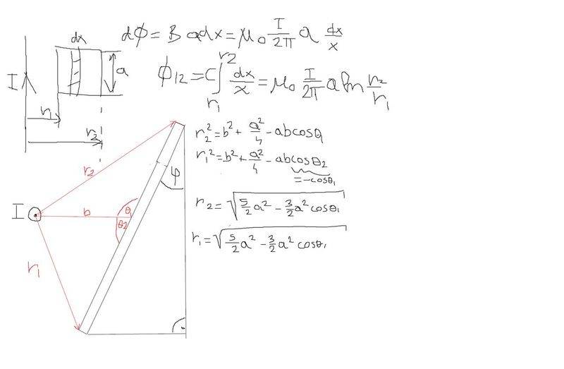

Also I tried my calculations with angle theta 2 for magnetic flux and induced emf as a function of time (theta2 = wt) and I got:
upload imagemtried to take derivative e(t) in respect to theta2 to get angle for maximum of function e(t) and I got:
-18(tan(x))^2 = 9 - (25/(cosx)^2)
which gives imaginary solutions.

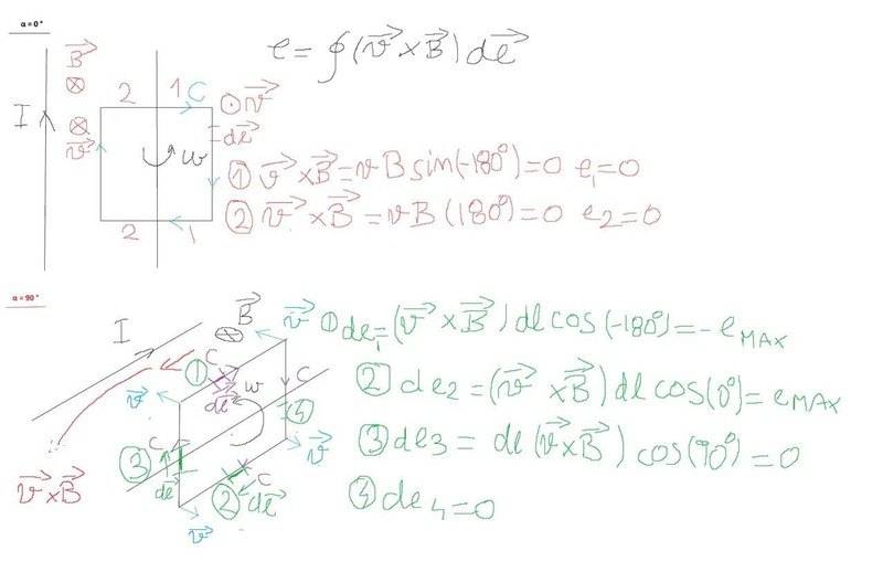

i have a hunch that the rectangular frame is rotating about an axis parallel to the conducting wire(Through which the current is flowing)
and the frames vertical arms will rotate to form a cylindrical sweep about the axis witha diameter equak to width of the rectangular frame.
therefore the arms of the frame will be parallel and the width will be perpendicular to the conducting wire(so no question of angular variations arise);try to imagine the flux passing through the area of the loop by integrating B.dA where dA is an elementary area
and then using Flux and angual velocity you can get the induced e.m.f.

Your 5/2 factors inside the square roots are wrong.
I don't know where your equation with a ln term in it comes from. I'm not that familiar with electromagnetics. Can you post a link as reference?
It seems intuitive that the maximum would be at Φ=0.

Correct, you got it .

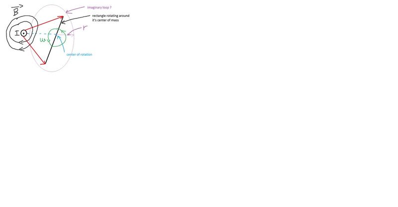

Well you can see it from my calculations I was doing the same thing just integrating by imagionary loop.

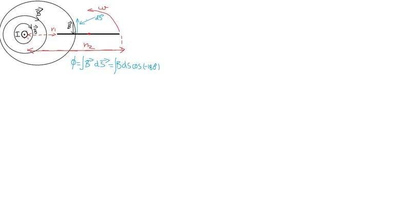

I found dA element(dS) and integrated it over r1 to r2, then I found flux as a function of time and took derivative of magnetic flux and that is fine , I get same results as in solutions, but their angle for maximum emf is pi/12 and therefore final solution is emax= 3*u0*I*w*a/10*pi
So you meant imagining loop this way as shown on my picture?

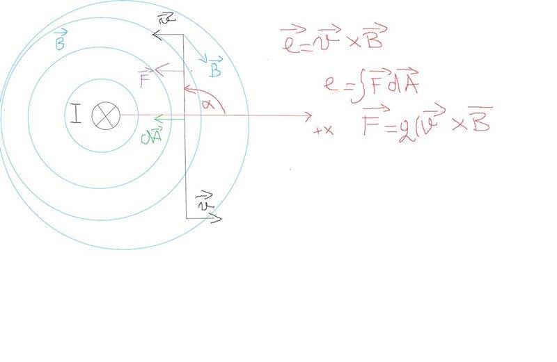

Maximum induced emf will be when Φ is maximum , so it's when vector dA and vector B are making cos(180) and cos(0) ,since B*dA*cos(B,dA(vectorially))
windows print screen

Well, it's not quite trivial because this is not a uniform field. The flux is denser closer to the wire. Also, when the square frame is at the φ=0 position, the sides of it are not traveling perpendicular to the field.
But you have not responded to my remark that the 5/2 factors are wrong in your expressions for r1 and r2 in your post #1.

Well , for me it's most intuitive that most flux will be flowing through rectangle when the position of the rectangle is at closest position to the wire .
I don't see how 5/2 factors are wrong
since
r^2 = b^2 + 1/4 * a^2 - ab cos(theta1) , and b = 3*a / 2 ,
so we get r^2 = 9/4 * a^2 + 1/4 * a^2 - a^2 * 3/2 * cos(theta1) = 5/2 * a^2 - 3/2 * a^2 * cos(theta1) ,
that is what I am getting maybe I am wrong
