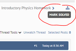

No, the thread has not been marked solved. Perhaps you saw the icon at the top right of the thread:
Screenshot of a forum thread header with a red circle around a grey MARK SOLVED button next to a network icon, beside the thread breadcrumb Introductory Physics Homework.
and concluded that it had been marked solved? That icon is actually a button for you to click on once you've decided that the problem has been solved to your satisfaction.
If the thread was actually marked solved then that button would read "MARK UNSOLVED", and you could retract the solved status by clicking on it. Hope that helps :smile:
