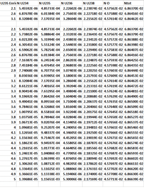

ok let's try to find the atom percent because the answer is given as ~66 percent oxygen, so that might be an option. because it's definitely not 88 % one.
So how do i get that?
mfb said:
UO2 - two out of three atoms are oxygen. 2/3 or 66.7%.
I tried but wasnt able to do it . This is basically the table i want. if i take the number density of O2 and divide by the total i get 66 %. so basically i can either get the number density or this percentage.http://imgur.com/a/2M4HH
I don't understand the problem.
By number of atoms, you have 66.7% oxygen, the result of a trivial calculation as shown above.
By mass, you have 12% oxygen, the result of the calculation you did above.
Those two numbers are not expected to be the same.
Where is the problem now?
Ok, The manual for this software is stupid. I know that the table is right so it might be from the number of atoms. Can you tell me how would i go about doing that
