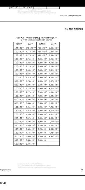

Hi Alex,
Thank you for your kind reply. I have taken the si sp data from ISO_8529_1(2001) Report. Here from the Source strength, i have taken the values as source probability. I didn't normalized the whole probability to one. I thought MCNP will do it itself. My MCNP Version is 5, I need to check the PHYS card. I am giving tha data table, from where i took the si sp values.
PF doesn't seem to like big images. I don't have that document but I have an idea what is in it. Histogram approximations of the source distributions. Try this,

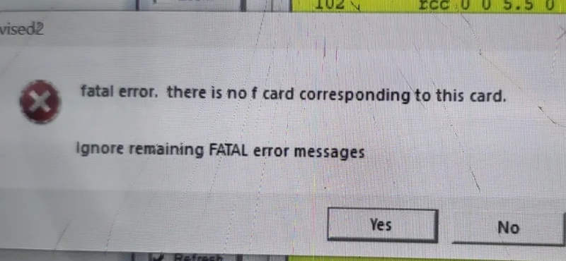

Hi Alex,
Thank you very much for your suggestions. I have modified the code according to your recommendations. The previous error has now been resolved, but a new error has appeared. I am attaching txt format of the code and a screenshot of the fatal error for your reference.
I am unsure where I might be going wrong. I would greatly appreciate your guidance in resolving this issue.
Thank you in advance for your help!
Best regards,
Anis
You have a third blank line in the input file again. The file should have two, one between the cell cards and the surface cards and another between the surface cards and the data cards. That is it. Another blank line I think is interpreted as the end of the problem.
I've fixed a bit of strange formatting. Five spaces for a follow on line.
The program needs the volume for cell 13 and it's failed to calculate it for some reason. You will need to calculate it and then put it as the result in the vol= part of cell 13 specification. I set that to 1 so the code would run, if you don't fix it you will get answers but they will be wrong.
Good luck again!

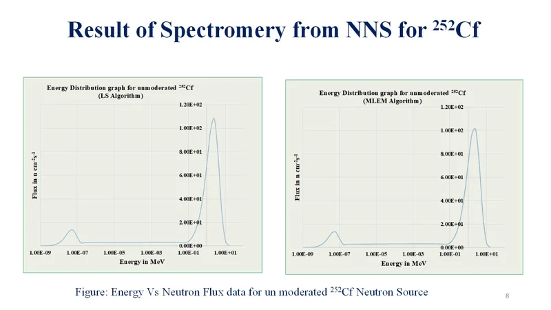

Hi Alex,
Hope you are well. The picture is the result of spectrometry from NNS for Cf-252. My target is to get the same result from my MCNP code. But, the result is not same. What should i do? Can you suggest me please?
I can't quite understand what the two graphs are. Is one what it is supposed to be and the other what MCNP produces through your tally? They look somewhat similar. Some nice titles explaining what they are would help.
To get the tallied graph looking like the original you will need some basic things.
You should graph your SI/SP to see if you are inputting the spectrum that you expect. Remember that you are giving energy bins and the bins are not the same size. This affects the graph.
You will need enough particles to sample the entire range of energies enough to get a good graph. I'm not sure if this is a problem or not.
You will need to have similar energy bins to the original graph. You could try copying the energy bins from your SI/SP cards. That will mean you change your e4 card.
