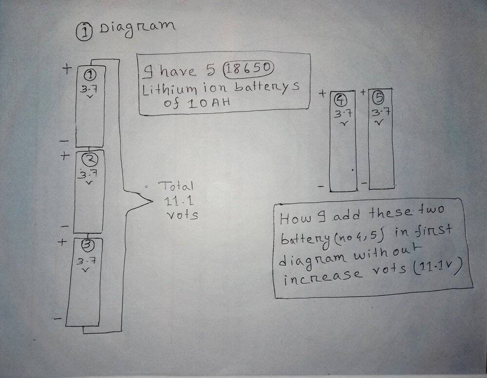

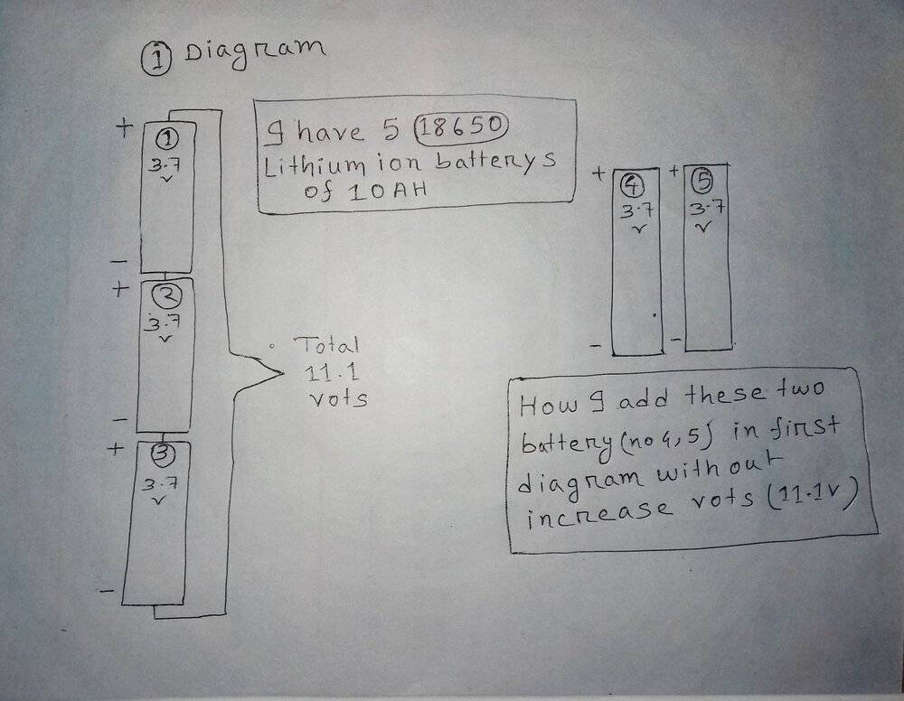

Hello Friends,
Please help me to setup 5 [18650] Li-Ion battery of 11.1 volt
I describe everything in image.
Please check attach file
Thanks in Advance

Not possible without having one battery destroyed when in use or charging. Find another use for the two extra batteries.

You could put all 5 batteries in series and use an efficient buck topology DC-DC converter to get you back down to the 11V. But I'm guessing that you don't have experience designing and building DC-DC converters?

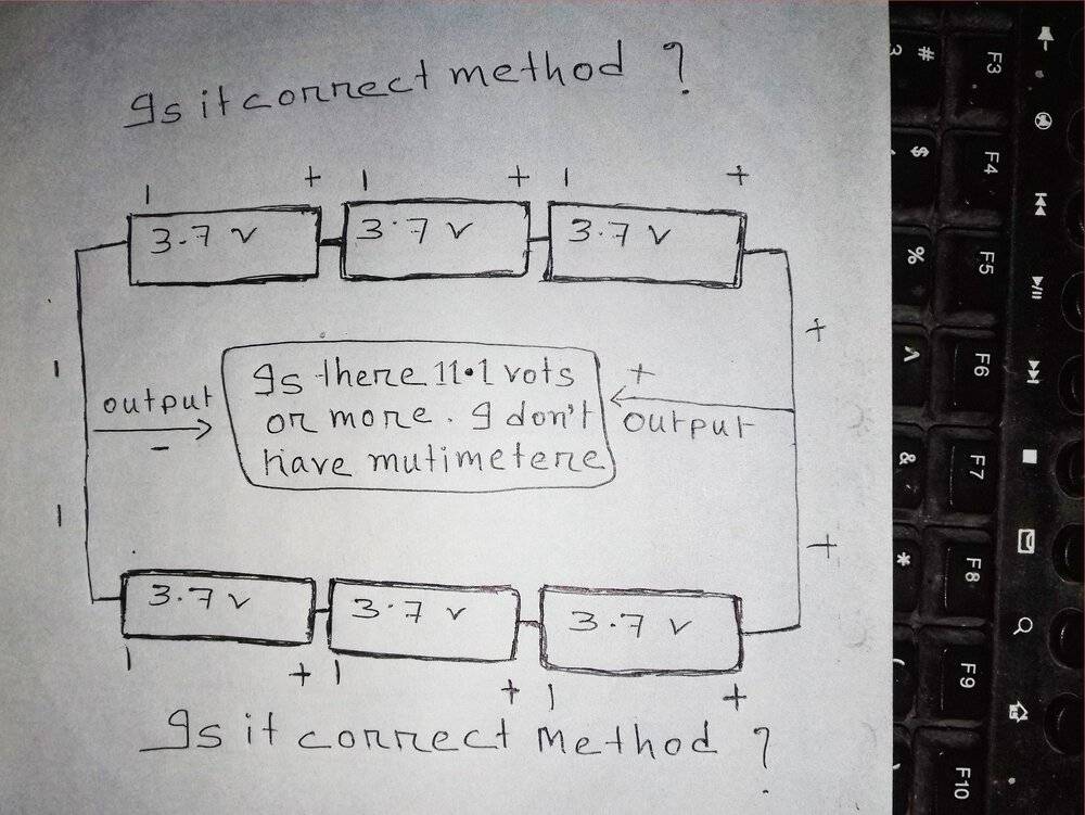

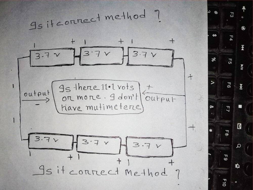

I know i am a nonsense guy. Please check my 2nd attach file. Help me once again and I will not ask you again for any kind of help in this post.
You can only parallel-connect batteries when they are well-matched. They would need to be the same age with the same charging history.
It seems like you are trying to do something pretty dangerous. What are you doing with these Li-Ion batteries? Are you familiar with the fire risk when working with batteries, especially Li-Ion batteries?
Do you have 5 batteries or 6? Sometimes you say or draw one and sometimes the other.
Oh, and I am sorry your soldering iron is no good, but we're really not responsible.
I must repeat the warning about connecting batteries in parallel unless they are properly matched. They can destroy each other and overheat. You could well be better off using just three at a time in series. If, as you suggest, you have no meter and you don't really want to get involved with additional circuitry then that may be the best solution, although it would mean half the available mAh.
Take care!

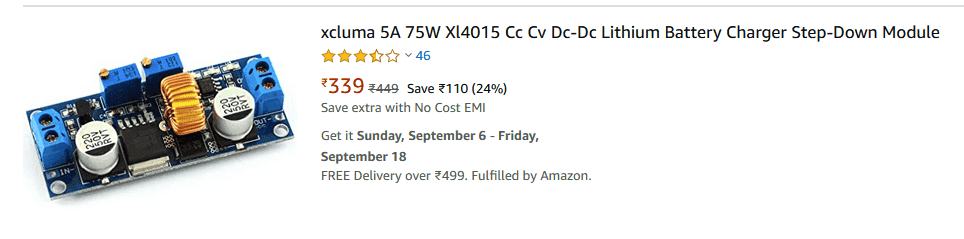

I am decided to make litium ion battery pack via 18650 battery upto 18ah - 20ah
Today I order this from amazon (xcluma 5A 75W Xl4015 Cc Cv Dc-Dc Lithium Battery Charger Step-Down Module)
I have solar panel also my lg monitor is 19 volt
Remaining items to buy:-
1. multimiter
2. 3s bms
3. 60 watt soldering iron
4. 10000 mah branded litium ion power bank for 18650 battery (it's a best idea to buy 18650 battery in cheap price)
If I am wrong then please correct my
