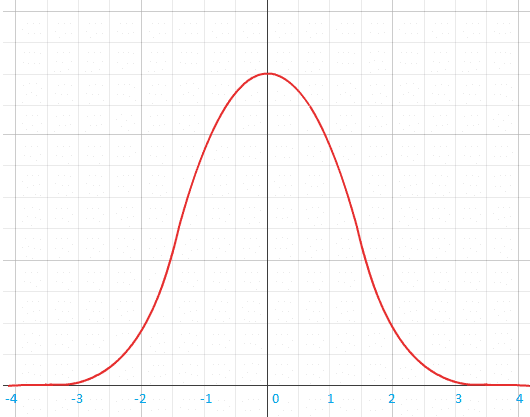

Consider a gaussian graph
Red bell-shaped curve on a grid with x-axis from -4 to 4, peaking near x = 0 and falling to near zero by about x = ±3.
let 5 quares on y -axis represent 1units
is it correct for me to say that the average value of the quantity on the y-axis is given by
y_av = (y_min + y_max) / 2
where y_min is smallest value of y in the graph = 0
y_max is the maximum value of y in graph = 2.4
average value of y, y_av = (0 + 2.4) /2 = 1.2
then, to find the area under graph, i use
area = y_av * (3 - -3) = y_av * 6 = 7.2
is this correct or wrong. in the above, i have all the things that i would if this was a question.
am i missing an assumption. the answer seems correct but is the method correct.
note that at this a-level, i don't have to know equation of gaussian graph nor do i do integration.
is this the correct way to find area under graph for non-linear graphs?? is there a general formula (not integration) for lower levels?
Try it again, and pay attention to details.
It isn't clear what you mean by "The average value of the quantity on the y-axis". You should state the problem exactly as your course materials state it.

oh, it's 4 squares. any way this was only an example. let's say its 5square. i don't have the correct graph. and take the values i gave as the correct value

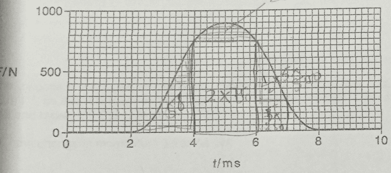

Graph of force F in newtons against time t in milliseconds, a bell-shaped curve rising from about 2 ms to a peak near 900 N at 5 ms and falling to zero by 8 ms. Handwritten annotations include a plateau at 4 to 6 ms and a rectangle labelled 2 x 10 with a shaded area.
need to show that momentum gained by ball is 2.7Ns

To find the average force acting between two times, say x = 4 and x = 6 seconds, you can divide the area of the graph under the curve between x = 4 and x = 6 seconds by the length (6-4) = 2. So counting the squares can be one step of that process.
.If you are given that the curve is gaussian with standard deviation 1 sec. , you can find the area by using a table of the normal distribution.

You need the integral of the F(t) curve between 2 ms and 8 ms. Do it by counting the small squares enclosed, and taking into account how much momentum one square means.
You have mentioned finding the average value of force. If you were taught to do the the problem this way, you could add up the force at intervals corresponding to the vertical lines on the graph, for example at times .002 sec,.0022 sec, .00024 sec ...0078 sec .008 sec and divide this sum by the number of terms you added. The average force times the length of the interval from .002 sec to .008 gives you an approximation for the area under the curve.
As echild says, you can also find the area under the curve by counting squares.
