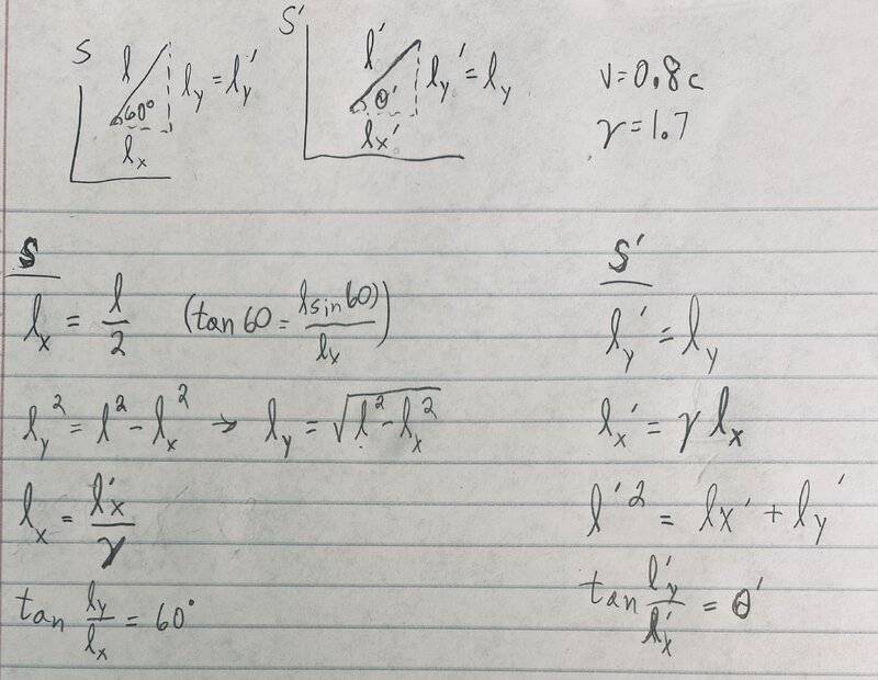

I appreciate the feedback, but I have all that as well. I have written out both triangles, all sides, all the trig for all sides, all pythagorean theorems for both underneath each individual triangle, all possible alternative eqs for each side for both, literally every single thing I could come up with. It's just I have to find 4 sides, albeit 2 of them are equal, but still unknown. So, essentially two triangles, three unknowns, and I can't see how to set them up so that I can cancel out other variables to get to one single variable for any given equation.
I have no doubt that tan is required, but I don't see how to set it up in a way to get down to just one variable. I'm thinking it's some property of tan that I'm not aware of. I'm coming back to this stuff after an 8yr layoff, so while I brushed up as best as I could before the semester, I'm still really rusty at this point.

Could you write out the equations you have for the two triangles so we can see what you have? Also, any equations relating the lengths of the sides between the two frames as well.
Here is 1 of 4 different times I've written it all out now. I'm just not seeing where to make the link. I use pythagorean theorem, and when I substitute, I end up canceling everything out and just getting ## l_x = l_x ##, which is obviously worthless.
**CORRECTION TO ABOVE IMAGE** - In ##S'## list, it should be ## l'^2 = lx'^2 + ly'^2 ##
I have substituted with tangents, that gets me nowhere as well.
I've put hours and hours into this and it's driving me nuts.
##l'^2=l_{x'}+l_{y'}## is wrong.
That has one thing you know and two you don't. Can you correct that and eliminate the things you don't know?
Then can you eliminate the two variables you don't know in the equation you get?
Then is there anything left to eliminate?
Post each answer you get if you get stuck.

I'm on my phone, so it's easier to use ##L## for the length of the stick in its rest frame and ##l## in the frame where it's moving.
First, we have:$$L^2 = L_x^2 + L_y^2$$Then, we know$$L_x = \gamma l_x, \ L_y = l_y$$Finally, we know$$l_x = l\cos \theta, \ l_y = l\sin \theta$$That gives you ##L^2## in terms of ##l^2##, ##\gamma## and ##\theta##.
I FINALLY got it when I got home this afternoon. I did end up using the tangents after I finally saw how to cancel things out and get it down to one variable
In case anyone else has this problem, the direction I went was this:
## tan(60) = l_y/l_x ## and ## tan(\theta') = l_y'/l_x' ##
## l_y = l_y' ## and ## l_x\gamma = l_x' ##
Using that information, I set the two tangents as a ratio over each other, the sides all cancel each other out, and I'm left with ## \theta ##. Just basic trig from there out.
Thank you so much for everyone's help. I did correct the typo you cited earlier Ibix (I was in a rush at the time), and I do plan to try to go in the direction both you and PeroK were citing above, just so I can get down a different method as well for future problems. Hopefully if anyone else runs into this issue down the road, this will get them through it
