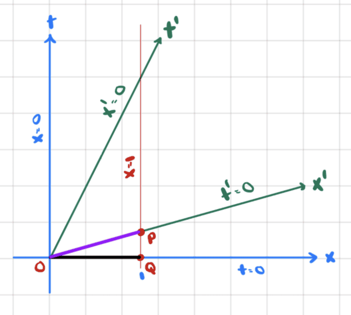

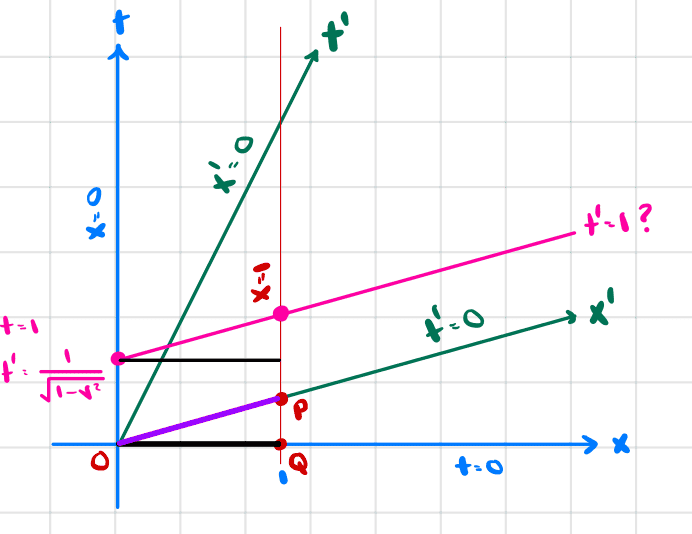

I have a question about the concept of length contraction.
The black line from (0, 0) to (1, 0) represents a meter stick in my stationary frame, call it frame A. The blue axes represent my coordinate system with coordinates x and t.
The green axes represent the coordinate system of a moving frame, call it frame B, with coordinates x' and t'.
I assume frame B moves along the positive x direction and there is no movement along y and z directions.
Since the meter stick is at rest in frame A, we can easily determine its position in spacetime in frame A as time increases. Considering just the endpoints of the meter stick, x=0 and x=1 represent the so-called world lines of these endpoints: they stay in the same position forever.
What about from frame B's perspective?
O and Q do not have the same time coordinates in frame B and thus are not simultaneous.
On the other hand, one end of the meter stick at a certain t>0 represented by point P (at which t'=0) is simultaneous with the other end of the meter stick in frame B.
This is still difficult to imagine for me, but I think I understand the argument.

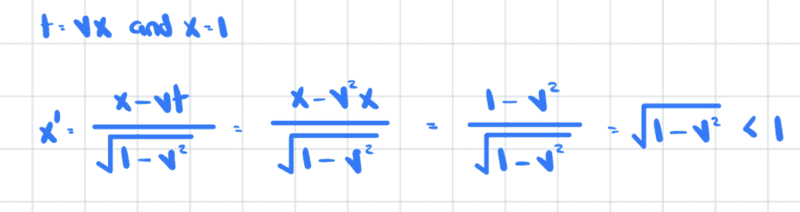

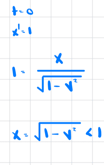

If we calculate the x' coordinate of point P we get
Hence, the meter stick as "seen" from frame B is shorter. I put "seen" in quotes because, again, it is still difficult to digest this idea of seeing a shorter meter stick.
Also, this length seems to have nothing to do with the geometry of the picture I drew: the purple segment should be longer than the black segment. From my previous questions on this subject, I gather this is because the geometry of spacetime is not Euclidean.

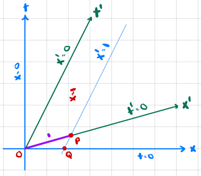

Now, what happens if we think about a meter stick in frame B as seen from frame A? From B's perspective, the meter stick is at rest, but it is moving from A's perspective.
The world line in frame B is x'=1: the meter stick stays at x'=1 forever.
Pictorially, we have
with the meter stick in B being OP and in A being OQ.
If we calculate the length of OQ we reach
My question is the following.
Let's say we have a meter stick in frame A. Frame B sees it as a stick with length ##\sqrt{1-v^2}##.
How many sticks are there? Just one?
Why does it/does it not make sense to speak of frame A "seeing" this shorter length stick that frame B sees (thus seeing it even shorter), and so on, infinite times? What's wrong with this reasoning?

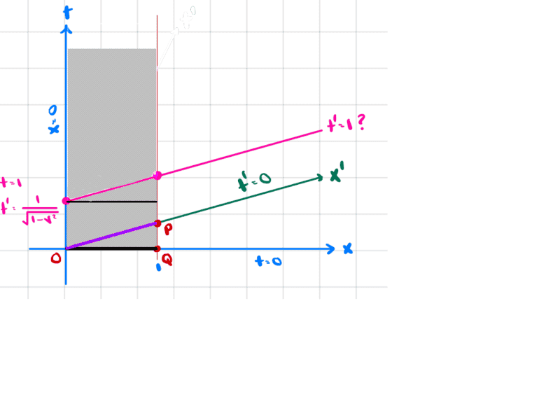

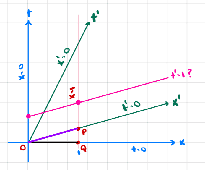

In addition, what happens at t'=1?
It seems it would be
The stick would seem to be represented by the segment between the two pink points. If this is so, then the stick just keeps having the same length forever in frame B, it's just a bit shorter than in A.

Yes, there is just one stick. A frame does not correspond to a separate reality but a different description of the same reality.
The frames will disagree on the length of the stick as well as on what events of the end-points that are simultaneous.

There are 2 sticks.
Your first calculation is about a stick at rest in frame A.
Your second calculation is about another stick at rest in frame B.

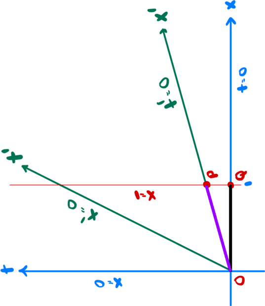

I regard the Minkowski diagrams in Susskind's book (and in many other books) as incomplete, because they don't show the scales of the axes. The primed and unprimed axes have different scales in such a diagram.

To clarify: I agree with this. The OP has considered two different sticks (that coincide spatially at a particular time in the primed system). I may have read the OP a bit fast. My answer replied to a common misconception that an object somehow ”belongs” to a particular frame and that an object ”in” another frame is necessarily different.
… and to make this a bit more concrete:
OP is trying to apply the Euclidean length to these lines, which is doomed to fail because spacetime has Minkowski geometry, not Euclidean.
The easy way to see that the purple line is shorter is to note that both lines have the same ##\Delta x## and that the length of a spacelike interval is given by
\Delta L = \sqrt{\Delta x^2 - \Delta t^2}
It should be clear that of all intervals with the same ##\Delta x##, the one with ##\Delta t = 0## will be the longest.
The argument is exactly the same as for time dilation.
No. The black line represents the meter stick (the only one in your scenario) at the instant of time t = 0 in your stationary frame.
The meter stick itself, as a physical system in spacetime, is the set of worldlines of the points on the stick. In your diagram, this would be the set of vertical lines between, and including, the x = 0 line and the x = 1 line.
The blue line between points O and P then represents the meter stick at the instant of time t' = 0 in the moving frame.
The above statements, when properly considered, resolve the questions you have.

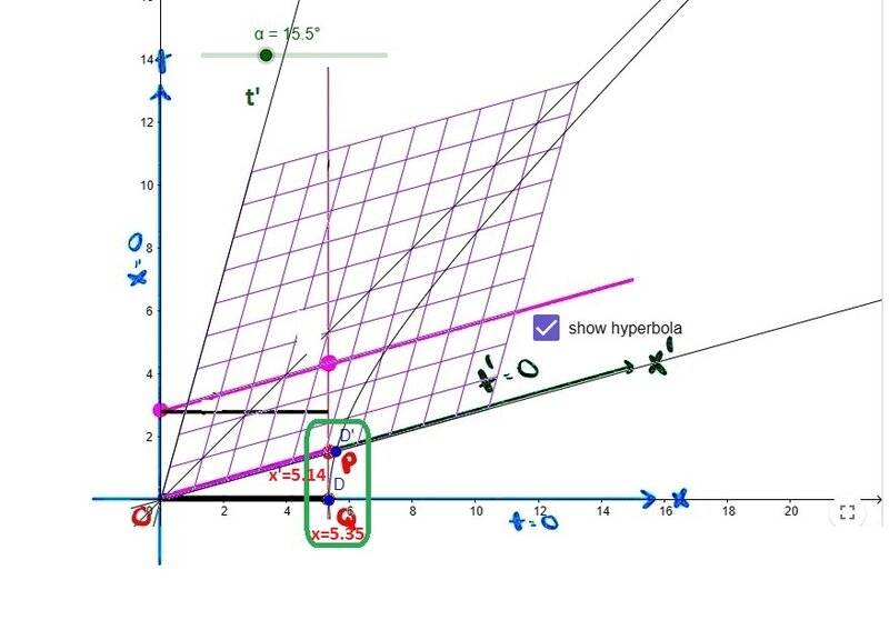

I'm not sure, whether I understand the question right, but could it be that the confusion comes from not correctly constructing the unit text on the primed frame, for which you have to use the corresponding space- and time-like unit hyperbolae?
Here's a Minkowski diagram demonstrating length contraction:
The vertical black lines are the ends of the rod, whose length is measured, having length ##L_{\text{A}}## ("Alice's frame", ##\Sigma## = rest frame of the rod). The blue hyperbola is the hyperbola defining points at this distance ##L_{\text{A}}## from the origin. The green point defines the point of the right end of the rod as measured at time ##t'=0## by Bob simultaneously with measuring the position of the left end from his point of view (at rest in the frame ##\Sigma'##). This clearly shows that ##L_{\text{B}}## is smaller than ##L_{\text{A}}##, indicated by the black intersection point of the hyperbola with Bob's ##x'## axis.
When reading a Minkowski diagram you have to completely forget about our Euclidean thinking of the plane. The "distances" are to be determined using the Minkowski pseudo-metric rather than the usual Euclidean metric.
Of course not. The lengths that you are "reading off" from your picture are Euclidean lengths, not Minkowski lengths.

There is one meter stick in the diagram, and it consists of the set of events that's shaded in the modified diagram below. This is the set of all points between x=0 and x=1 at any time t.
The straight line curves such as the sold black line from (x=0,t=0) to (x=1,t=0) are subsets of the one ruler, snapshots of the ruler at a specific time.
The ruler has the same length in the stationary frame at times t=0 and t=1, as shown by the two black lines on the diagram. These lines are not the entire ruler, they are snapshots of a subset of the ruler at some particular instant in time in the stationary frame. There are of course an infinite number of such snapshots of the ruler at different times, the set of all such snapshots comprises the ruler.
The purple and pink lines are also subsets of the set of events comprising the ruler, but they occur at a constant value of t'=0 and t'=1.
Again, there are an infinite number of such subsets, at different values of t'.
The length of the subset of points at a given time is different depending on whether t is held constant or t' is held constant. Mathematically, it can be found by taking the invariant lorentz interval between the beginning and ending points of the line segment, which is given by ##\sqrt{\Delta x^2 - c^2 \,\Delta t^2}##.
