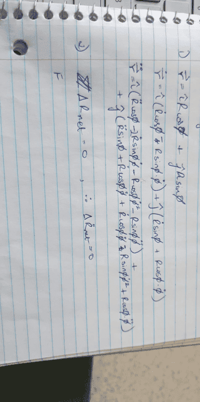

I don't know how to take polar derivatives.
r = Rcos(theta) + Rsin(theta)
This is what I have so far, please need urgent help. I don't understand and know what to do.
For the first part, I got a really long answer, for the second part I am trying in terms of mv^2/r = mg, or mg = m*(answer to first), but I am getting nowhere. PLease help
Please show your work. We don't give answers away but point out mistakes.
This is all I have, I don't know what to do after, I've been stuck for 2 days, and its due in half an hour.

As long as the bead stays on the surface ##\dot R## = 0. That should simplify things for you.
Is my second derivative right?
What forces should I use to try and solve the second part.

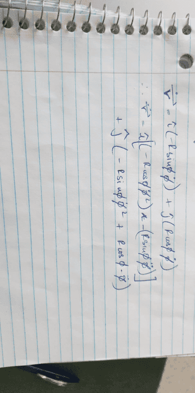

Please show the revised velocity and acceleration in view of my comments in post #4. You cannot proceed to the second part unless you get the first part right. If you have to post pictures (a practice we discourage) at least make sure they are right side up.
I tried mv^2/r = mg and mr''= mg. None of them are working
You need to write a vector equation. How many different forces act on the bead when it is on the surface at angle φ? Write their vector sum in unit vector notation and set it equal to ##m\vec a## in unit vector notation. Your expressions for the velocity and acceleration are correct.

Sorry, it is against forum rules. Do your best. Identify the forces that act on the bead, draw a free body diagram and use it to write each force in unit vector notation.
