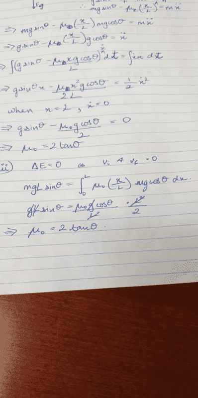

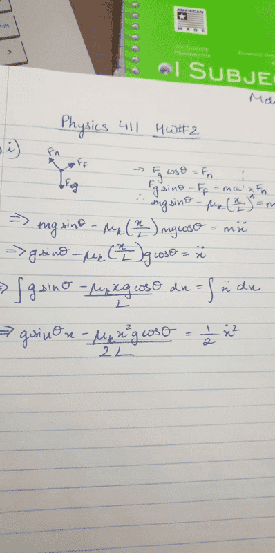

Attached Below.
So far, I have this:
For Part ii) I know that:
mgh = xmgsin(theta), but I don't know how to go further
You know how much potential energy the object started with. Presumably you realize that it started and ended at rest -- that is, with zero kinetic energy.
So you can easily calculate how much energy was expended over the course of the downward slide. The work done over a path is given by the length of the path times the average [over distance] force along the path.
Does that give you a start?

Yes, except that "average force" is defined as average over time. You mean "average over distance".
Which is why I specified an average over distance.
My intuition is also screaming that due to symmetry, the two averages will match in this case.
So you did - sorry.
Wouldn't it be SHM (until the bottom)? The two averages differ for that.
OTOH, looks like the question can be answered using a symmetry argument without needing to mention averages or perform integrals.
Is this correct? How do I take the integral in the next part?
For the first part, your two methods are effectively the same (and correct).
For the next part, I gave rather a large clue in post #6. Apart from the constant force of gravity, the force is proportional to what? Does that ring any bells?

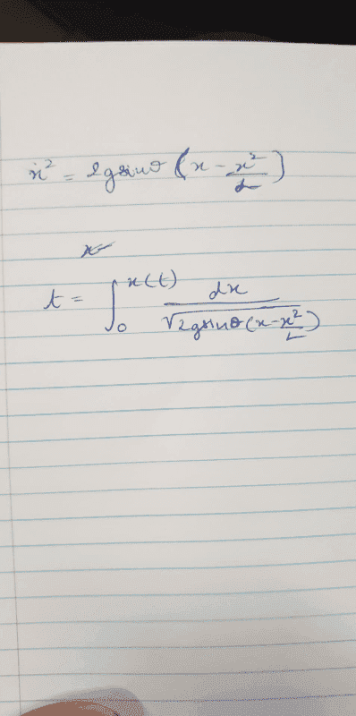

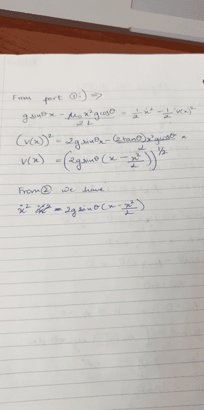

Is my equation for Q3 right? If so how do I go about solving it?
The easy way is to recognise your first equation in post #7 as being (almost) a well known standard equation, with ##\ddot x## on one side and a term proportional to -x on the other.
Failing that, your v(x) = equation in the middle if the second image can easily be turned into time = an integral of a function of x wrt x.
The first step in solving the integral is to get rid of the x term (as opposed to the x squared term) by a simple change of variable. That will give you a constant term instead. Post what you get.
Then think about another substitution to get rid of the square root. I'll let you have a go at that before any further hints.

What change of variable are you referring to? Could you please start me off with the first step?
I got to this, what's next?
A simple shift in x (adding a constant) can eliminate the linear term, giving an expression of the form ##A\sqrt{1-cx^2}##.
A multiplicative substitution gets rid of c.
Do you see what to do from there?
Yeah i got it, thanks !
