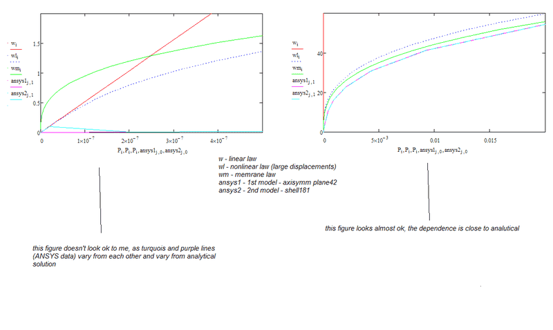

I am analyzing the deflection of clamped circle polysilicon membrane with radius=1500 um and thickness=1 um. The load is constant pressure ranging from 20 uPa to 20kPa.
The problem is that my analytical solution doesn't agree with the ANSYS solution.

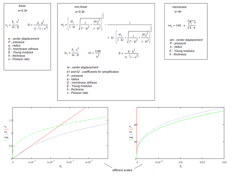

2.1. Timoshenko gave me formulas for linear, non-linear and membrane regions of displacement. See the 1st attachment "pic1.png" for formulas and figures depicting them.
2.2. 1st ANSYS model is axisymmetric, consists of plane42 elements
2.3. 2nd model is made of shell181 elements
both input files are in attachment "input.txt"
The solution data that I get from ANSYS is on 2nd attachment "pic2.png". The ANSYS and analytical graphs differ and that's the problem. I suspect that the problem is in my ANSYS model. Any comments will be appreciated.

Hi saikin, welcome to PF!
Nice presentation. So it looks like ANSYS gives anomalously low deflection for very small pressure values, but reasonable deflection for higher pressure values? If ANSYS is set to nonlinear mode, is it possible that it's stepping up the load in increments, and there's no accurate deflection data below the smallest increment?

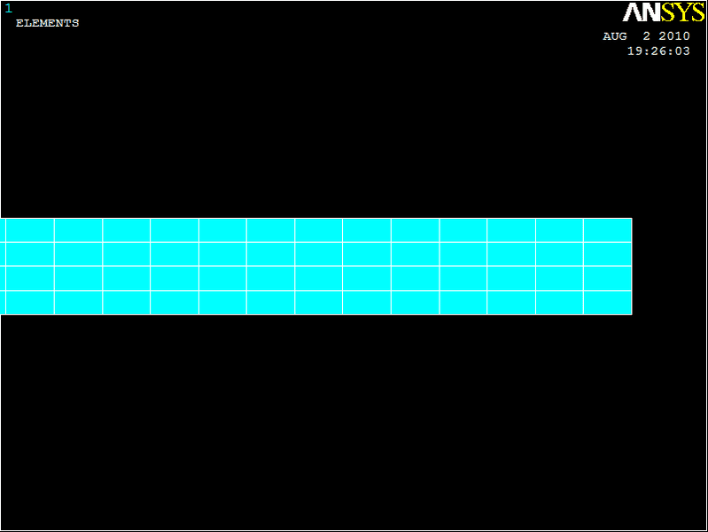

You may want to post your mesh just so we can rule that out as a possibility for errors. Also, read carefully though the element technology guide to make sure that those plane elements are applicable.

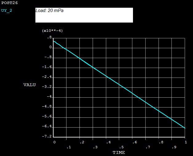

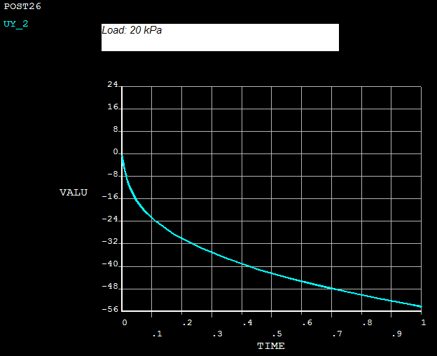

However, the time/load history graph looks interesting:
1st - time-history20 kPa.png for 20 kPa load - looks the way it should be. Negative sign is ok, as it is Y axis deflection.
2nd - time-history20 mPa.png for 20 mPa load - looks very strange. The sign changes from positive to negative at some point, which is very strange. Why there is a positive region?
minger, please find the mesh on third pic in attachment. The plane42 seems to be suitable as it has large deflections and stress stiffening features.

It appears as if the second analysis doesn't use any substeps while the first one does.

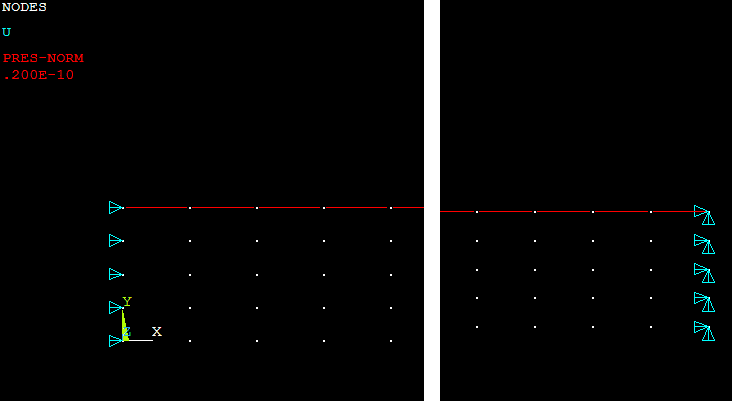

As far as the first axisymmetric analysis, exactly how are you applying the load? Can you repost the mesh with loads and constraints?
minger, they both have the deltim,1/200,1/1000,1/10 specified.
Here is the new mesh with BCs.

It is an interesting verification you use, which i might want to use as well. where did you find te analytical solution for the membrane deflection? I found the linear solution in chapter 3 of timoshenko's Theory of plates and shells, but the other expresssions are harder to find.
do you know if they are aavailable as well for square plates?
