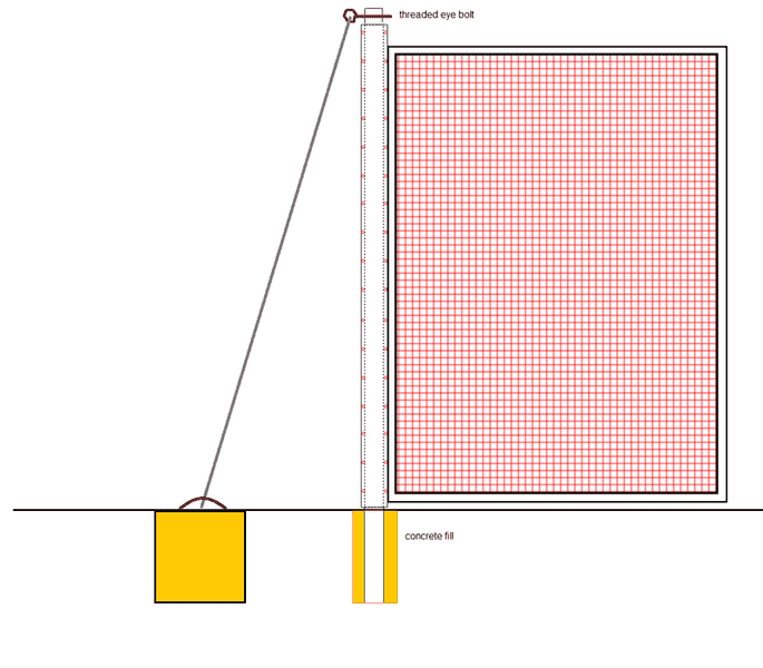

I hope I'm not too late to this party, but if I understand your issue, there's only two realistic ways of preventing sagging unless you have some other means of supporting the gate.
Referring to this picture, you can either make the internal pipe thicker, but that doesn't really increase your interior pipe's rotational resistance (i.e. you could triple the thickness and maybe get 20% less sag out of gate. If you could counterweight the sag, though, you could have a pretty stout gate. With the set up in the picture, you would need to have a cable/eye bolt with a working capacity of (Weight of Gate * Width of Gate)/(2*Height of Gate*cos(angle that cable makes with ground)). For example, if your gate weighs 500 lb, is 8' wide 12' tall, and the cable is 60 degrees to the ground, then you will have:
Tension = 500lb*8ft/(2*12ft*cos(60)) = 400lb.
Note**** make sure your concrete counterweight is at least as heavy as your estimated tension, with a few hundred extra pounds to be safe (one foot of concrete = 150 lb).

There are two forms of "sag" one encounters in a gate. One is deformation of the gate itself. In order to prevent this the structure needs to have an appropriate internal guy or brace. It is the truss like structure that is of importance. Old farm gates had a single heavy diagonal from upper post end to bottom latch end. More artistic gates are often a true truss structure as required by visual presentation. In either case the load can be estimated by assuming the total weight applied at a lever arm 1/2 the length from post to latch.
The other source of sag is from the post deforming from vertical. Infinitybyzero has a good idea on this. A back tie of some type is critical. The load (as torque applied to the post) can be approximated as the weight of the gate at a length 1/2 of the distance from post to latch. Remember that this calculation is not true at the top of the post. It is the torque applied at the middle. Thus the load that needs to be supported at the top of the post is approximately 2x the calculation. The anchor that he shows for the post is also important The torque on the post will be essentially a rotation about the center of the post. This torque is also always perpendicular to the gate. When you open it or move it off axis the orientation of the force moves also.

1) The pipes are essentially infinitely stiff compared to the gate leaf (if you are using light, thin tubed sections). You could have a 10" solid steel round bar for a gate post and your gate would still sag if it were made of very light metal.
2) Concrete fill would not increase the bending stiffness of your support by a significant amount, since you're just adding material to the center of gravity of the pipe itself.
