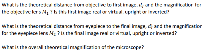

For this problem,
Distance from objective to object ##š‘‘š‘‚ = 10.6cm##
Distance between the objective and eyepiece ##š· = 34cm##
For (b) I got ##d_I = 26 cm## and ##M_1 = -2.4## which means that firsts image is inverted and real
For (c) I got ##dI' = 35 cm## and ##M_2 = -1.3##. However, I thought ##dI' < 0## since the second image is virtual and inverted from a ray diagram.
For (d)
I got ##M = M_1M_2 = 3.2## which is interesting since the finial image is inverted
Can someone please tell me whether I am correct and how to tell the second image is virtual without drawing a ray diagram?
Many thanks!

Thank you for your reply @BvU!
Distance from objective to object ## d_O = 10.6cm##
Distance between the objective and eyepiece ##D = 34cm##
Is the given information (the data collected from the experiment)
Relevant equation:
- thin lens formula ##\frac{1}{d_O} + \frac{1}{d_I} = \frac{1}{f}##
- Magnification formula ##M = -\frac{d_{O}}{d_I}##
Many thanks!

Well it did in the labs! We used a 150 mm and 75 mm convex lens to make a microscope and adjusted the distances accordingly to get a clear image.
Many thanks!
My ##d_{O'}## for is the real image formed by objective lens. I use that virtual object for the eyepiece.
##\frac{1}{26} + \frac{1}{dI'} = \frac{1}{15}##
##d_{I'} = 35 cm##
Many thanks!

How come you think this image is formed at a distance of 26 cm from the eyepiece ?

True, that might be a mistake. I guess 26 cm is the distance from the real image from the objective lens not the eyepiece so I guess the distance to the real image from the eyepiece should be ##34 - 26 = 8 cm## this gives
the finial image to be - 17 cm from the objective lens.

A remark about accuracy: you have input with 2 to 2½ digit accuracy. You want to do your calculations with at least that and only round off properly at the end. So NOT ##d_{O'} = 8 ## cm but 8.355 and then ##d_{I'} = -18.86 ## cm, so you get -18.9 cm, not -17 !
So: what's the performance of your 'microscope' ?

Sorry, what do you mean by performance of the microscope?
Many thanks!
Magnification :smile:

For the total magnification I get ##-2.4 \times 2.4 = -5.8## which means that it must be an enlarged and inverted image
