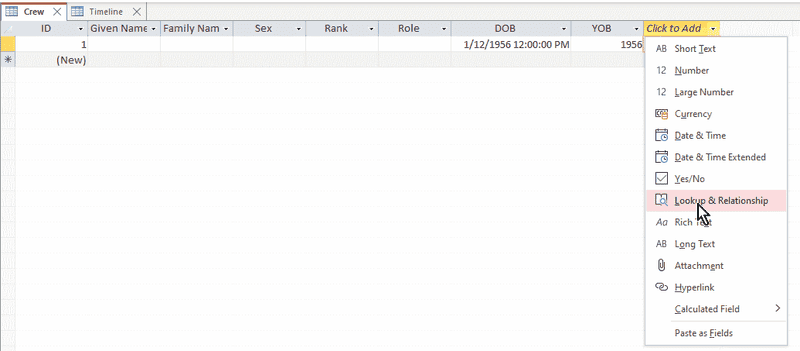

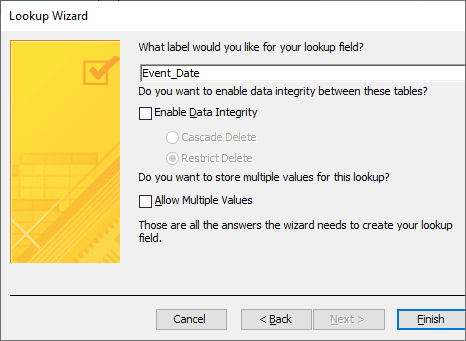

I'm using the latest version of Access on Windows 10 and want to calculate age from a date of birth field in one table and an event date in another and it's not working ☹
Having exceeded the limits of Excel to track the names, rank, attributes, etc. of a list of ship's crew, I have tried to use Access.
First up...
I'm not a database expert. So, I'm muddling along with help from YouTube, but either I can't frame a correct search for this problem or it's not commonly asked and so I'm stuck. Basically, what I want to do is calculate the age of crew by taking the date of a known event in one table, and their date of birth in another, and subtracting the years.

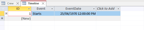

- Timeline, which has one entry of 'date' type.
Microsoft Access Timeline table in datasheet view with columns ID, Event and EventDate; one row shows ID 1, Event Starts, EventDate 25/06/1970 12:00:00 PM.

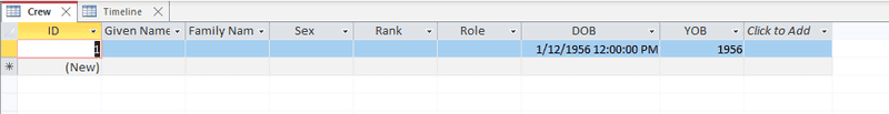

- Crew, which has one entry with multiple attributes that include DOB of 'date' type.
Screenshot of a Microsoft Access table named Crew with columns ID, Given Name, Family Name, Sex, Rank, Role, DOB and YOB; the single record shows DOB 1/12/1956 12:00:00 PM and YOB 1956.
As a test, in the 'Crew' table I have used the Year() function to confirm that I can access the DOB field and that the correct year of birth is extracted. However, when I try and create a calculate relationship that uses the Year() function from the Timeline table, it returns the wrong value:

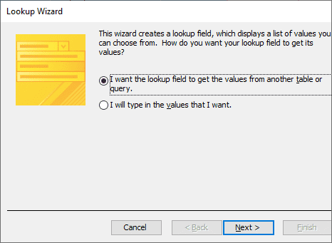

Microsoft Access datasheet of the Crew table with fields ID, Given Name, Family Name, Sex, Rank, Role, DOB and YOB, one row showing DOB 1/12/1956 12:00:00 PM. The Click to Add menu is open listing field types such as Short Text, Number, Date & Time and Lookup & Relationship.
Lookup Wizard dialog with the first option selected: I want the lookup field to get the values from another table or query.

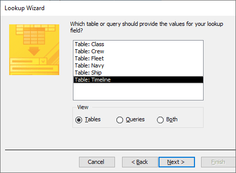

Lookup Wizard dialog asking which table or query should provide values for the lookup field, listing Class, Crew, Fleet, Navy, Ship and Timeline with Timeline selected.

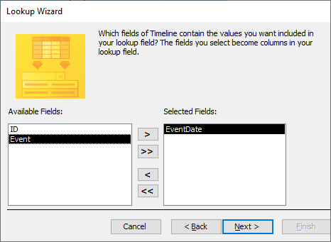

Lookup Wizard dialog in Microsoft Access asking which fields of Timeline to include; Available Fields list shows ID, Event and EventDate, with Selected Fields empty.
Screenshot of the Access Lookup Wizard asking which fields of Timeline to include; EventDate is the only selected field, with ID and Event listed as available.

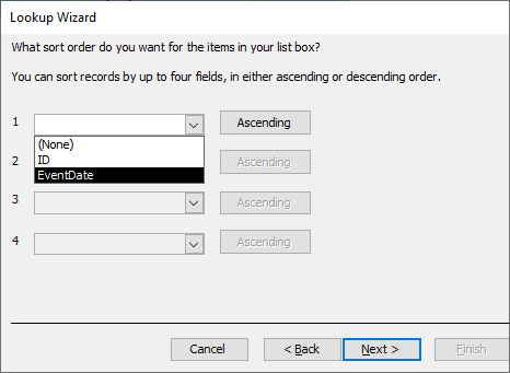

Access Lookup Wizard step asking sort order for list box items; first field dropdown open showing (None), ID and EventDate options, with Ascending buttons beside four sort rows.

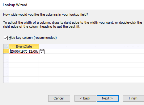

Access Lookup Wizard step showing a single column named EventDate with the value 25/06/1970 12:00 and a calendar icon, with the Hide key column option ticked.

I have reached the limit of attaching screenshots, but the Wizrad results in an 'Event_Date' field in the Crew table that shows the correct 1970 date. But if I now apply the Year() calculation to the 'Event_Date' field, it results in the number 1899.
It is not obvious what I am doing wrong, but any thoughts would be appreciated!

There is no obvious relationship between a crew member and an event, so adding an "AgeAtEvent" column to the Crew table makes no sense.
Instead you should create a new query which at a minimum contains Crew.ID, Crew.DOB, TimeLine.ID and TimeLine.EventDate for all combinations of crew members and events. You can then add a calculated field to that query which contains the crew member's age as of the event date.
Yes, this is the way to go. I don't think you can add a calculated field using the simple query wizard so you will have to use the query builder.
