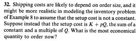

Minimization problem: Economics: quantity to order
Karol
1,380
Minimum/Maximum occurs when the first derivative=0
$$Q=\sqrt{\frac{2(K+pQ)}{h}}~\rightarrow~Q=\frac{2}{h}(KM+pM)$$
##Q'=0~## gives no sense result
You cannot just write ##Q = \sqrt{2(K+pQ)/h}##. You must start the whole modelling procedure over again.

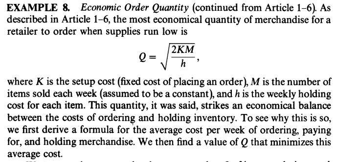

In the old model, the average cost per week was given as
$$C(Q) = \frac{KM}{Q} + \frac{1}{2} h Q \; \hspace{2cm} (1) $$
Solving ##C'(Q)=0## gave the economic order quantity as ##Q = \sqrt{2KM/h}.##
What is the equation that replaces (1) in the new model?
In the old model:
$$A(Q)=\frac{KM}{Q}+cM+\frac{hQ}{2}$$
Where c is the purchase cost of one item. in the new model:
$$A(Q)=\frac{K+pQ}{Q/M}+cM+\frac{hQ}{2}=\frac{KM}{Q}+(c+p)M+\frac{hQ}{2}$$
And differentiating gives the same result
Karol said:
In the old model:
Correct.
