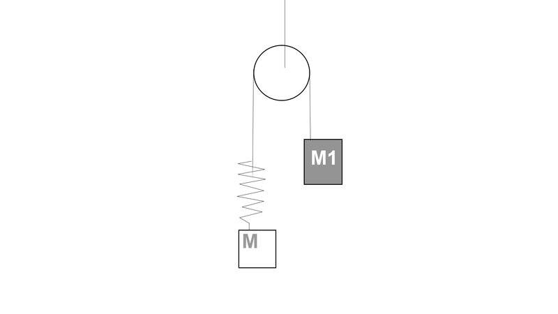

FInd min mass so that block loses contact with ground.
Diagram of a pulley with a string over it: on the left a spring hangs down to a square block labelled M resting on the ground, and on the right a grey square block labelled M1 hangs freely.
Spring is initially in its natural length, the mass attached to spring is on ground(M)
Equations of conservation of energy
Min compression = 2mg/k to lift up object, Normal rxn=0
1/2kx2=m1gx
⇒ m=m1
Can someone tell me if I am right or not

Which mass is on the ground? Is the other mass suddenly released, or is it lowered gradually?

Then m1 is suddenly released?
Chestermiller said:
Then your answer is not correct. From your equation, what is kx equal to?
k is spring constant and x is displacement from its natural length
1/2kx^2 is potential energy stored in spring which is equal to gravitational potential which is M1gx

Like I said, from your equation, what is kx equal to?

I love physics said:
1/2kx2=m1gx
⇒kx=2m1g
⇒k2mg/k=2m1g
Therefore, M=M1
That's not what I get. I get $$kx=Mg=2m_1g$$
So, ##M=2m_1##

The compression in spring should be 2mg/k in order to lift it up, therefore i replaced x by 2mg/k

Force balance on M: $$N+kx=Mg$$where N is the upward normal force exerted by the table on M. When N = 0 (M loses just loses contact with the table),
$$kx=Mg$$

so answer should be M/2?

No. I mean mechanistically the reason that, in order for M to lose contact, ##m_1\geq M/2##. Certainly, if m1 were lowered slowly, the condition for loss of contact would be ##m_1\geq M##. So why, in the case where ##m_1## is released quickly, can ##m_1## weigh less and still cause M to lose contact even if it is only half of M? What is the motion of ##m_1## like?
If it is released from rest it will produce potential energy energy in the spring, which will further be transferred to our original block M
and if it is lowered slowly change in potential energy will be negligible

Here's my spin on this. After you release m1 quickly, it begins falling, but then overshoots the equilibrium displacement by a factor of 2. So the tension in the cord and spring when m1 reaches its lowest point will be 2x the value at the equilibrium displacement. If, on the other hand, m1 is lowered slowly (say by hand), it will stop moving downward when it is at 1x the equilibrium displacement.
