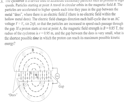

Minimum time through a cyclotron
The discussion revolves around calculating the minimum time for a particle to traverse a cyclotron, focusing on the relationship between speed, energy transfer, and the magnetic field. The key points include the need to account for the time taken to complete semi-circular paths and the energy imparted by the dees during each rotation. Participants emphasize the importance of determining the maximum speed supported by the cyclotron, which is influenced by the radius and the magnetic field. The equations for work done and rotational time are discussed, highlighting the complexity of deriving a formula for minimum time. Overall, the conversation seeks to clarify the calculations necessary for understanding particle motion in a cyclotron.

v initial is also equal to 1000
the only time the particle actually speeds up is during the crossing of the dees. so
integral of of Vdx = the maximum energy of the system, but i don't know how to make this into an equation that will give me minimum time.
any help would be great!

you need to add the time taken to go round those semi-circles …
that will depend on v and on the (constant) magnetic field B :wink:
i understand that the time taken to go around each time is the same, so basically i need to find how many rotations it will take to get to the maximum speed that the cyclotron will support.
this brings me to my problem how do i get the amount of energy transferred by the dees each rotation.
the radius of the outside will determine my maximum speed correct?
so r=mv^2/qvb?
and how do i get the speed each dee imparts?
kulgan said:
… and how do i get the speed each dee imparts?
work done = qV ? :wink:
(((qr2B2)/m)-500)/1000)+1 gives number of semi circle rotations.
time through a rotation is given by 2pi*r/v/2
so how do you determine the time through a rotation?
it should be the same time for each one but now I'm unsure how to determine what it should be...

from your equation r=mv2/qvb :smile:
