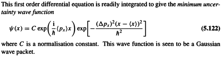

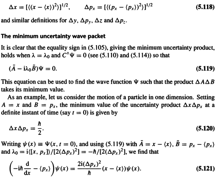

The following equation (5.122) is the minimum-uncertainty wave function, which is a Gaussian wave packet. Since it is Gaussian in ##x##, we may get ##\Delta x## directly from the ##\sigma## of the Gaussian distribution: ##(\Delta x)^2=\frac{\hbar^2}{2(\Delta p_x)^2}##. We have ##\Delta x\Delta p_x=\frac{\hbar}{\sqrt2}##, which contradicts the fact that the wave function has minimum uncertainty, ie., ##\Delta x\Delta p_x=\frac{\hbar}{2}##.
Derivation of (5.122):

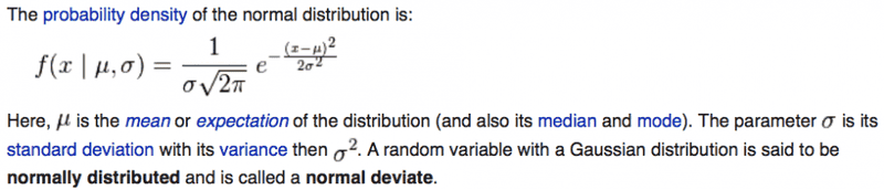

You should first calculate ##|\psi(x)|^2## and then extract ##\Delta x## from there, not from ##\psi(x)##
