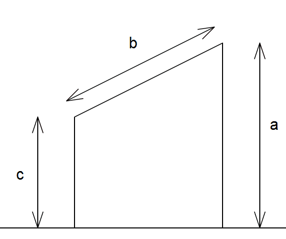

What is the minimum velocity required to throw a ball over a house with a pitched roof ( See attachment for the figure) You can choose the throwing point as needed
(Choose throwing point standing near a and facing left) Assuming b is the hypotenuse of a right triangle and a-c is one side we can find the other side (let's call it d) using the Pythagorean theorem b^2 -(a-c)^2 = d
= -a^2 +2ac +b^2 -c^2
a is the maximum height of the projectile
a=(v^2sin^2θ)/2g
assuming d is the range
d=v^2sin(2θ)/g
I tried creating an equation forvfrom these equations , but it turned out to be too massive to even make a sensible answer.
Please help.

Not necessarily. You should only assume the trajectory passes through the top of each vertical (a and c).
Different d?
Let x be the distance of the launch point from the first vertical, v the launch velocity and θ the angle. Write down the equations of motion and find what the requirement of just clearing the two verticals tells you. Then use calculus to find the least v. If you're familiar with them, could be a job for Lagrange multipliers.

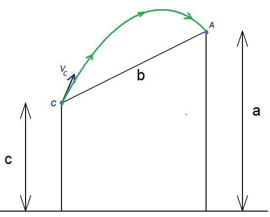

You might first consider a related problem. What is the minimum speed VC require to toss a ball from point C to point A in the attached figure? (Or, if you prefer, what's the minimum speed VA required to toss a ball from point A to point C?)
If you could solve that, I think you could use the result to find the answer to the original question. I don't believe you need to worry about what point on the ground the ball should be thrown from.

Sorry for the late reply, I contacted my professor and he said no rolling is allowed, the ball should aim not to touch the roof at all if only extremely lightly.

For a projectile, fixing the speed at one height will automatically determine the speed at every other height. So, suppose you find the minimum speed the projectile can have at point C, say, such that it barely makes it to point A. That speed at C will fix the speed that the projectile needs to be launched from the ground.
To find the speed at C, you don't need to find the maximum height. Imagine launching the projectile at C at some angle θC. Can you find an expression for the launch speed VC as a function of θC that will just get the projectile to A. Then, as you said, you can use calculus to minimize that function to determine the minimum speed at C that will get the ball to A. Then you can find the launch speed from the ground.

From C to A, the projectile moves along the curve
y=c+xtan(θ)-(g/2) x2/(Vccos(θ))2.
It has to touch the pitch at height y=a and x=d. You can find Vc2 in terms of theta, and find its minimum.

As you said earlier, it reduces to lobbing the ball from one end of the roof just fast enough to clear the far end. Writing down the two equations of motion for a ball thrown at angle theta, speed v, then eliminating time, we get the parabola:
y =x tan(θ) - g x2 sec2(θ)/2v2
To clear the far end:
a-c = d tan(θ) - g d2 sec2(θ)/2v2
where d is the horizontal distance to the far end. Whence
2v2/(gd) = sec2(θ)/(tan(θ) - (a-c)/d)
= (1+t2)/(t - h), where t = tan(θ), h = (a-c)/d
By Pythagoras, 1+h2 = (b/d)2
Whence 1+t2 = 2(h + b/d)(t-h)+(t-h-b/d)2
So 2v2/(gd) = 2(h + b/d)+(t-h-b/d)2/(t-h)
This is minimised wrt t when t-h-b/d = 0, leaving v2/(gd) = h + b/d
v2 = g(a - c + b)

Yes, that gets it without calculus. Nice. Did you work out the final answer? I was a little amazed at the form it takes.
TSny said:
Did not see that trick at all!
Well, of course I solved it with calculus first, then figured that if I subtracted the answer from the non-optimised expression I should get a squared term that vanished at optimum. Wouldn't have found it otherwise.
Yes, it's astonishing. Makes one think there's a much easier way.
