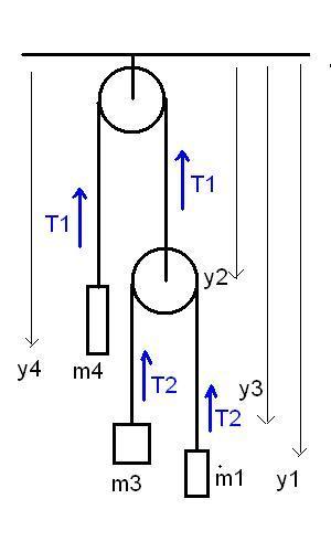

A light smooth pulley is attached to a support a fixed height above the ground. An inextensible string passes over the pulley and carries a mass 4m on one side. The other end of the string supports a similar mobile pulley; over this passes a second string, carrying masses of 3m and m on its two ends.
Deduce the acceleration of the three masses
N2, Lagrange Equations
I solved this already and got the correct answer using Lagrange's Equations. Now I try again with Newton's Eqns. The final set of three equations I obtain from Newtonian analysis are satisfied by the accelerations I got when I solved via Lagrange's Eqns. However, I cannot actually solve the three equations to obtain a unique solution (they are a linearly dependent set). What I need is another equation which I cannot get.
No picture was given, so I created my own and I will describe what I did.
Forces on 4m mass give eqn: T - 4mg = 4ma1, a1 the acceleration of mass 4m. This is also the tension on the other side of the same pulley. Since this pulley is the fixed pulley, it has an upward force equal to 8ma1 + 8mg
The string then passes down to the mobile pulley. Upward force on this is 4ma1 + 4mg. Consider the 3m mass: Net force is 3ma2 + 3mg and that of the m mass is ma3 + mg.
Now I used these to construct suitable equations. The net upward force on the mobile pulley is equal to the sum of the tensions 3ma2+3mg and ma3+mg. So 4ma1 + 4mg = 3ma2+3mg+mg+ma3 giving 4a1 - 3a2 -a3 = 0. (1st EQN). The tension on either side of the mobile pulley must be the same => 3ma2 + 3mg = mg + ma3 so 3a2 - a3 = -2g. (2nd EQN)
Finally, the net upward force on the fixed pulley is equal to twice the tensions on either side of the mobile pulley => 8ma1 + 8mg = 2(3ma2 + 3mg + 3ma2 + 3mg) giving 8a1 - 12a2 = 4g. (3rd EQN)
This set is linearly dependent ,so I have a free parameter
Is there another eqn I can get somewhere?
Also, now that I think about it, why is my 1st EQN valid? This pulley is mobile so its upward force need not equal the sum f two tensions below it?
Many thanks.
Note that the tension in the rope by which the light (massless), mobile pulley is drawn must equal twice the tension wound about it, in order for that pulley's acceleration to be finite.
Perhaps that was the equation you were lacking?
You should have 4 equations, for unknowns a_1 and T_1 (related to the fixed pulley), and a_2 and T_2 (related to the mobile pulley)

Let's see:
T_1-m_1g=m_1a_1 (eq.1)
T_2-m_2g=m_2(a_1+a_2) (eq.2)
T_2-m_3g=m_3(a_1-a_2) (eq.3)
T_1=2T_2 (eq.4)

Nope. The pulley is massless (m=0), yet is subject to Newton's laws of motion.
Thus, if there is an imbalance of forces working on it, it will have infinite acceleration.
Oops, why did I put in those g-factors?
Dividing (2) and (3) with respective masses, adding them together for a_2-removal, and using (4) for T_2 removal should yield (5):

We therefore have, from (5):
T_{1}=\frac{4m_{2}m_{3}}{m_{2}+m_{3}}g-\frac{4m_{2}m_{3}}{m_{2}+m_{3}}a_{1}
We gain, by insertion:
\frac{4m_{2}m_{3}-m_{1}(m_{2}+m_{3})}{m_{2}+m_{3}}g=\frac{4m_{2}m_{3}+m_{1}(m_{2}+m_{3})}{m_{2}+m_{3}}a_{1}, that is
a_{1}=\frac{4m_{2}m_{3}-m_{1}(m_{2}+m_{3})}{4m_{2}m_{3}+m_{1}(m_{2}+m_{3})}g

Only in the INERTIAL frame relative to the fixed pulley.
Your a_2 can be written as a_2=-a_1+a*, where a* is the relative acceleration of mass_2 to the moving pulley, which is -a_1.
Similarly, because the rope around the mobile pulley must remain fixed in length,
your a_3 can be written as a_3=-a_1-a*
Note that the terms -m_2a_1 and -m_3a_1 can be regarded as contributions from the fictitious forces in a non-inertial frame of reference.

No to the second, it is not, because the moving pulley system is NON-INERTIAL.
Thus, the correct representation relative to the moving system accelerating with -a_1 is:
-(-m_2a_1)+T_2-m_2g_2=m_2a_2,
where a_2 is the acceleration of m_2 relative to the moving pulley.
The first term is the fictitious force associated with the noninertial frame's acceleration, relative to an inertial frame.
Note that THIS force law is equivalent to the one I gave.

To restate, for mass 2:
We clearly have:
T_{2}-m_{2}g=m_{2}a_{2,abs}
But, that can still be written, "inertially", by setting a_{2,abs}=-a_{1}+a_{2,rel}
as:
T_{2}-m_{2}g=m_{2}(-a_{1}+a_{2,rel})
which, to transform it to its NON-inertial form reads:
-m_{2}(-a_{1})+T_{2}-m_{2}g=m_{2}a_{2,rel}
I hope that clears up most of your confusion, rather than adding to it.

OKAY, let's have a look at the original:
" T - 4mg = 4ma1, a1 the acceleration of mass 4m. This is also the tension on the other side of the same pulley. Since this pulley is the fixed pulley, it has an upward force equal to 8ma1 + 8mg
Finally, the net upward force on the fixed pulley is equal to twice the tensions on either side of the mobile pulley => 8ma1 + 8mg = 2(3ma2 + 3mg + 3ma2 + 3mg) giving 8a1 - 12a2 = 4g. (3rd EQN)"
1. "T - 4mg = 4ma1, a1 the acceleration of mass 4m"
Agreed!
2. "This is also the tension on the other side of the same pulley"
Agreed!
3. "Since this pulley is the fixed pulley, it has an upward force equal to 8ma1 + 8mg"
Agreed, but why bother with this static pulley at all?
4. "The string then passes down to the mobile pulley. Upward force on this is 4ma1 + 4mg."
Agreed.
5. "Consider the 3m mass: Net force is 3ma2 + 3mg"
True, this is in an inertial frame, with absolute acceleration, and your "net force" is T_2
6. "that of the m mass is ma3 + mg"
Also true, and this also equals T_2
7. "The net upward force on the mobile pulley is equal to the sum of the tensions 3ma2+3mg and ma3+mg. So 4ma1 + 4mg = 3ma2+3mg+mg+ma3 giving 4a1 - 3a2 -a3 = 0. (1st EQN)"
True.
8. "3ma2 + 3mg = mg + ma3 so 3a2 - a3 = -2g. (2nd EQN)"
True.
9. "Finally, the net upward force on the fixed pulley is equal to twice the tensions on either side of the mobile pulley => 8ma1 + 8mg = 2(3ma2 + 3mg + 3ma2 + 3mg) giving 8a1 - 12a2 = 4g. (3rd EQN)""
This is where your linear dependence arrives, it is nothing else than your first equation, where you said T_1 equals the sum of the two tensions from below.
Agreed!
Agreed!
Agreed.
True.
True.
10. What you are lacking then, is a similar eq. as in 8 for the other mass, and in addition, either the requirement that the two lower tensions must be equal to each other, or the tricky condition that the accelerations a_2 and a_3, for you absolute quantities must have a relation to each other on the requirement that the rope about mobile pulley remains of constant length.
Thanks arildno, I have to go now, but will work on it later.
