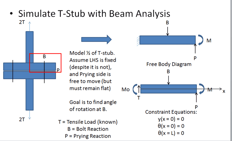

Hi all, I am trying to find the slope of a T-stub joint at the bolt in order to find the bending stress of the bolt.
I have drawn 1/2 of the T-stub as a beam. The beam analysis requires (for physicality) that the slope at each side of the beam to be zero. There is an applied load, a bolt load, and a prying load.
This problem is certainly statically indeterminate... I have tried a few methods of circumventing this (superposition, deflection equations) yet still always end up with 1 more unknown than equation.
Can anyone take a look and see if (a) I am making the right assumptions, and (b) how to tackle this problem?
Much appreciated!
  • Slide titled Simulate T-Stub with Beam Analysis showing a T-stub under tensile load 2T, a half-model free body diagram with loads B, P and M, and constraint equations y(x=0)=0, theta(x=0)=0, theta(x=L)=0.
I have since updated my analysis by assuming the deflection at the bolt is equivalent to the bolt reaction divided by the bolt stiffness, kb.
I have attached all of my equations.
I am getting Rb = 43 and Rc = 13 , (with applied load of T = 30) in my beam analysis.
Modeling the beam in ANSYS i get RB = -10, RC = 20 ... So there appears to be an error somewhere.
Anyone feel like looking through my scribble to help me out?
Any help would be greatly appreciated!
