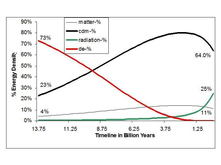

This post simply represents a learning process, my own. As such, it is only attempting to understand how the energy density might have changed with time and what can be inferred from this. There are 3 diagrams attached to this post, figure-1 is an attempt to show the relative density of matter, CDM, radiation and dark energy as a function of time, figure-2 shows the value of (H) resulting from the combination of these densities, while figure-3 is sourced from the following site based on WMAP data: http://universe-review.ca/F02-cosmicbg.htm
As stated, I am not trying to pretend that this is anything but a very simple model and therefore its only real purpose is to try and confirm whether the basic assumptions on which it is based are, in principle, valid. This requires some explanation of how figure-1 was drawn. As a starting point, the present-day critical density is assumed to be 9.54E-27 kg/m^3, which is then converted to an energy density of 8.53E-10 joules/m^3. From this the corresponding energy density components have been defined
(1) Matter....4% 3.41E-11 joules/m^3
(2) CDM...23% 1.96E-10 joules/m^3
(3) Dark Energy... 73% 6.23E-10 joules/m^3
The issue of the present-day radiation energy density proved problematic within the model, but I will come back to this issue after introducing a few other basic assumptions. However, the following link defines the radiation energy density as 0.64E-13 joules/m^3 by way of reference: http://hyperphysics.phy-astr.gsu.edu/hbase/Astro/neutemp.html#c1

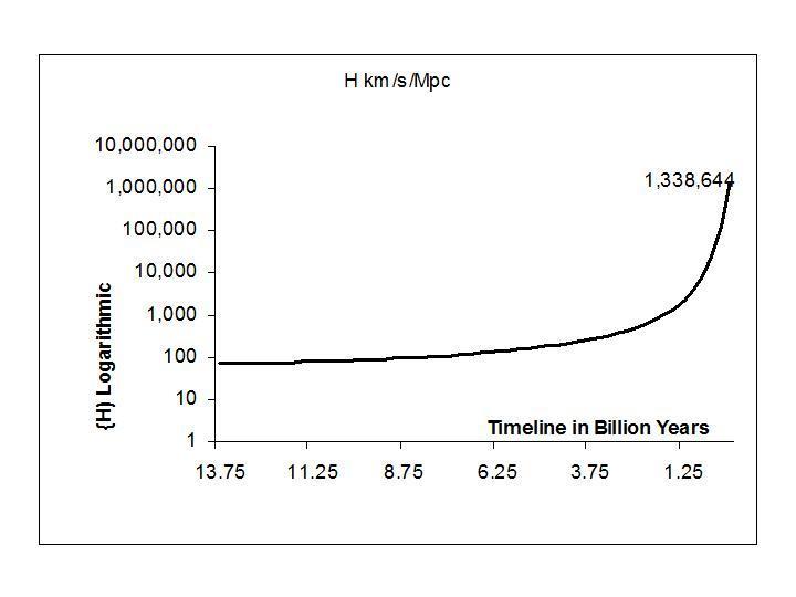

At first glance, the results in figure-3 seem to be reflected in figure-1. However, the only way I could make this fit was to assume a much higher value of the radiation density than that provided in the earlier ‘hyperphysics` link. The starting radiation energy density had to be set to 2.39E-12 j/m^3 rather than 0.64E-13 j/m^3 in order to arrive at the required 25% figure at 380,000 years. Given that the rate of change of radiation density is driven by equation (8), i.e. -4H*rho, it is not totally clear why this discrepancy occurred, therefore any clarification would be welcomed along with any other deeper insights to this process.
I have some additional issues which I have outlined in post #2. Thanks
  • Line graph of % energy density against timeline in billion years, from 13.75 back to near 0. Red de-% falls from 73% to 0%, black cdm-% rises to about 80% then drops to 64.0%, thin black matter-% stays near 4% to 11%, and green radiation-% rises from near 0% to 25%.

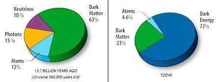

  • Two pie charts of the universe's energy content. Left, 13.7 billion years ago: Dark Matter 63%, Atoms 12%, Photons 15%, Neutrinos 10%. Right, today: Dark Energy 72%, Dark Matter 23%, Atoms 4.6%.

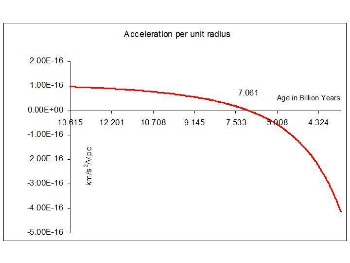

While it is accepted that the model results, outlined in post #1, are based on a very crude approximation, they seems to reflect a process that would explain the phase transition from a universe whose expansion initially slows under gravity, due to matter and CDM, to a universe whose expansion starts to accelerate under the effects of dark energy. A rationalised form of the acceleration equation can be presented in the form:
(9) a/r = -(4/3)*pi*G*rho(1+3w)
Again, substituting for (w):
(10) matter & CDM [w] = 0……. a/r = -(4/3)*pi*G*rho
(11) radiation [w] = 1/3…………. a/r = -(8/3)*pi*G*rho
(12) dark energy [w] = -1………. a/r = +(8/3)*pi*G*rho
While the energy density of dark energy becomes comparable to matter+CDM in figure-1 around 9.5 billion years, equation (12) suggests that dark energy would be twice as effective per unit of energy density and act in opposition to gravity. Therefore, dark energy would have started to reverse the slow down due to gravity at an earlier time, i.e. 6-7 billion years?
As explained previously, the only purpose for this model is simply to help gain a more intuitive picture of the effects of expansion on energy density, which might hopefully then lead to a better understanding of other effects. However, there are a few things that puzzles me about this model:
1) What drove the expansion of the universe in the first place?
2) Figure-1 suggests that the gravitational energy density of CDM, radiation and matter would have overwhelmed the expansive effects of dark energy in the very early universe?
3) Equally, if dark energy only expands space, i.e. infers no momentum on the objects being moved apart, what else expanded the early universe?​
Again, any clarifications of these issues would be welcomed.

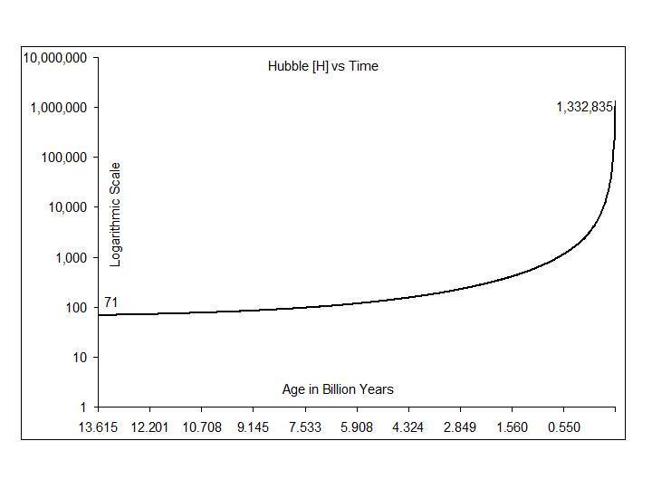

Part 2 of 4: Results of the Model
Following the initial posts #1-4, posts #5-8 reflect the assumptions and issues surrounding the calculation of the basic timeline of the LCDM model. As such, I would welcome any verification of my assumptions. Thanks
For consistency, the results are presented in the format style of the earlier graphs in post #1, but as now attached to this post. To do this, these results were actually produced by a spreadsheet implementation of the Javascript presented in Part-3. The main difference in comparison with the earlier graphs is the value of the present-day radiation energy density has been changed to align to accepted WMAP data. This value is much smaller than my earlier assumption and results in the transition from a matter-to-radiation dominated universe being much more abrupt and within the immediate timeframe of CMB decoupling, i.e. +400,000 years.
However, the main point to highlight is that the estimate of the age of the universe is now calculated as the sum of all the [dt] values calculated. The following results are a snapshot of the output of the Javascipt in Part-3 with z=1090 as an input.
  • Log-scale line graph titled Hubble [H] vs Time: H rises from 71 at 13.615 billion years ago to 1,332,835 near the present, steepest at recent times.

So what about acceleration?
It can be seen that equation [4] comes with an inference that acceleration is negative by default, but the interpretation of acceleration being positive or negative often depends not only on the rate of change, i.e. rising or falling, but also on whether it acts in the same direction as the velocity vector. However, based on the attached diagram showing the results of equation [4] plotted against time, it is not entirely clear to me how the sign of the result might be interpreted given some of the ambiguity about the direction of velocity. However:
o Let’s assume we follow the normal arrow of time in the forward direction.
o While the direction of the velocity vector associated with equation [2] is ambiguous to me, let’s align to observation and assume that it has to be expansive, i.e. positive.
o On this basis, acceleration before 7 billion years was rising from a large negative value to a smaller negative value because it was always acting in opposition to expansion?
o By the same token, the acceleration after 7 billion years is positive because it is increasing and acting in the same direction as expansion.
Of course, the issue with this interpretation is that there appears to be no obvious `cause` for the assumed expansion within the confines of the model, although this position clearly contradicts observation. For obvious reasons, I would welcome any clarifications of my interpretations.
  • Line graph titled Acceleration per unit radius, plotting km/s^2/Mpc on the vertical axis against age in billion years on a reversed horizontal axis from 13.615 down to about 4.3. The red curve starts near 1.00E-16, falls gradually, crosses zero near 7.061 billion years, and drops steeply to about -4.20E-16 at the right end.
